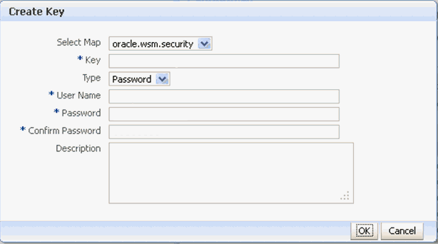

Click Create Key. The Create Key screen is displayed.
In the Key field, enter a value (for example, alltrials.auth.key) and enter the user name and password for InForm Adapter authentication.
Contact the InForm System administrator to obtain these values.Figure 5-4 Entering a Value in the Key Field
Click OK.
The new key will appear in the list of keys under the oracle.wsm.security group. This key value will be provided either in Configuration Wizard screens or in HS_TRIAL_SAFETY_CONFIG.dvm. The integration pack first checks HS_TRIAL_SAFETY_CONFIG.dvm for authentication parameters for a given trial. If the value is not found, it will read the value in the AIAConfigurationProperties.xml file, which is applicable to all trials on the SOA server. Integration pack obtains credential information from the credential store through the key value. The credentials are then passed to the SOAP header when invoking InForm Adapter in secure mode.
