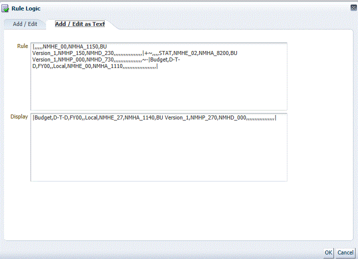

Use the Rule Logic Add/Edit as Text screen to add the rule to test manually as free-form text. This feature enables you to instruct the system how to display the actual value from the check rule logic. If you do not specify a display summary, then the report shows an unrelated value.
When the Display area is active, all interaction takes place in the Display area. For example, pasting a tree copies all tree members to the Display area. When the Rule area is active, all interactions take place in the Rules area. Changes made on the Lookup tab are reflected on the Rule tab in related editors.
To add a rule logic statement:
On the Rule Logic Editor, select the Rule Logic Add/Edit as Text tab.
