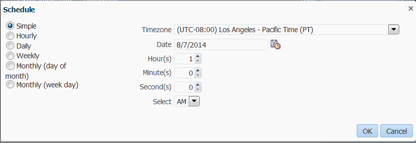

Image shows Schedule screen.

  3. Specify the type of scheduling and select the associated date and time parameters.
  4. Click OK.
Table 36. Schedule Types and Parameters
Schedule TypeData and Time Parameters
Simple
Submits the job for execution at a specific day and time, but does not repeat:
Options are:
  • Timezone
  • Date
  • Hour(s)
  • Minute(s)
  • Second(s)
  • Select (AM/PM)
HourlyExecutes at the specified minutes and seconds after the top of the hour every hour until cancelled. Options are:
  • Timezone
  • Minute(s)
  • Second(s)
DailyExecutes at the same time each day. Options are:
  • Timezone
  • Hour(s)
  • Minute(s)
  • Second(s)
  • Select (AM/PM)
WeeklyExecutes at the specific time for each day selected. Options are:
  • Timezone
  • Monday-Sunday
  • Hour(s)
  • Minute(s)
  • Second(s)
  • Select (AM/PM)
Monthly (day of month)Execute at the specific time for the day of the month selected. Also enables you to select the “Last Day of Month” or “Day Before End of Month”. Options are:
  • Timezone
  • Monthly Date
  • Hour(s)
  • Minute(s)
  • Second(s)
  • Select (AM/PM)
Monthly (week day)You can select the first, second, third, fourth, fifth, last and then the specific day or the week on which to execute the job. Options are:
  • Day of Month
  • Day
  • Hour(s)
  • Minute(s)
  • Second(s)
  • Select (AM/PM)
The Timezone drop down is not available for the Monthly (week day) schedule type.
