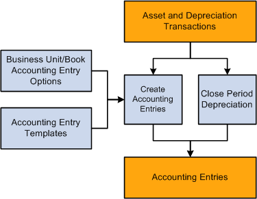

This diagram shows the processes for creating accounting entries:
Image: Processes for creating accounting entries
This diagram shows the processes for creating accounting entries.
