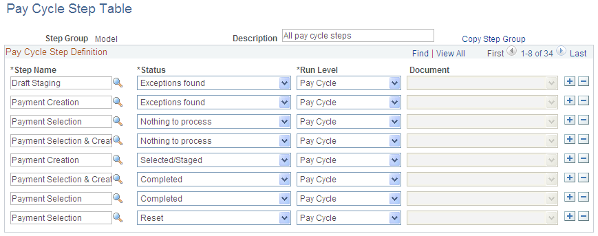

Pay Cycle Step Table Page
Use the Pay Cycle Step Table page (PYCYCL_STEP_TBL) to define step groups.
A step group contains all the possible steps that might be run during Pay Cycle processing. Each step is associated with a pay cycle status that indicates the order in which the steps are run.
Image: Pay Cycle Step Table page
This example illustrates the fields and controls on the Pay Cycle Step Table page. You can find definitions for the fields and controls later on this page.
A step group contains all the possible steps that might occur during processing. Each step is associated with a pay cycle status that indicates the order in which the steps are run.
