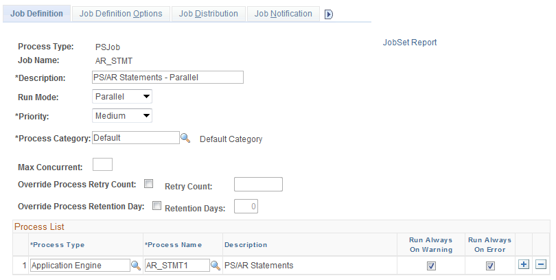

Adding More Parallel Processes to the AR_STMT Multiprocess Job
Use the Job Definition page (PRCSJOBDEFN) to add additional Statements process definitions to run the AR_STMT multiprocess job.
Image: Job Definition page
This example illustrates the fields and controls on the Job Definition page. You can find definitions for the fields and controls later on this page.
Job Definition page
