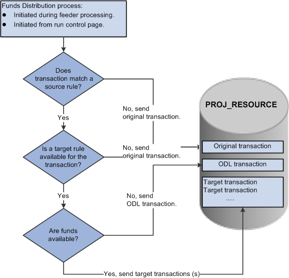

Image: The Funds Distribution process
This diagram illustrates the Funds Distribution process:
The Funds Distribution process consists of three primary steps:
Match a transaction to a source rule.
If a matching source rule is not found, the original transaction is maintained in PROJ_RESOURCE without further processing.
If a matching source rule is found, the process proceeds to the next step.
Determine if a target rule is available for the transaction.
If a target rule is not available for the transaction, the original transaction is maintained in PROJ_RESOURCE without further processing.
If a target rule is available for the transaction, the process proceeds to the next step.
Check for available funds.
If available funds are not found, the system creates an over the distribution limit (ODL) transaction in PROJ_RESOURCE.
If available funds are found, the system creates target distributions.
