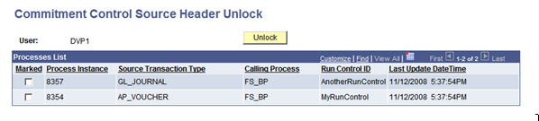

Use the Commitment Control Source Header Unlock page to unlock the KK Source Header for a failed request. (Commitment Control Review Budget Check Exceptions Source Header Unlock).
Image: Commitment Control Source Header Unlock page
This example illustrates the fields and controls on the Commitment Control Source Header Unlock page. You can find definitions for the fields and controls later on this page.
| Marked |
Select the data to cleanup by selecting this check box. |
| Unlock |
Click this button after you've marked the data you want to cleanup. |
The following data cleanup is performed:
Updates the KK Source Header Process status from I to N.
Unlocks the run control.
Unlocks the reserved temporary tables.
Deletes the State Records data.
Deletes the data in the temporary table if necessary.
Warning! This user interface is designed to perform all the necessary cleanup in order to rerun the Budget Processor. However, cleanup is not performed on other processes that may invoke the Budget Processor (FS_BP). If Budget Processor is invoked from another process, manual cleanup may be required before rerunning Budget Processor.

If the transactions have exceptions, you use the Transaction Exception component for the transaction type to review the exceptions, drill down to the source transactions, and with proper authority override the budget-checking errors.
Workflow Notification of Budget-Checking Results
You can set up workflow to notify you of budgets that have failed budget checking or received errors.
