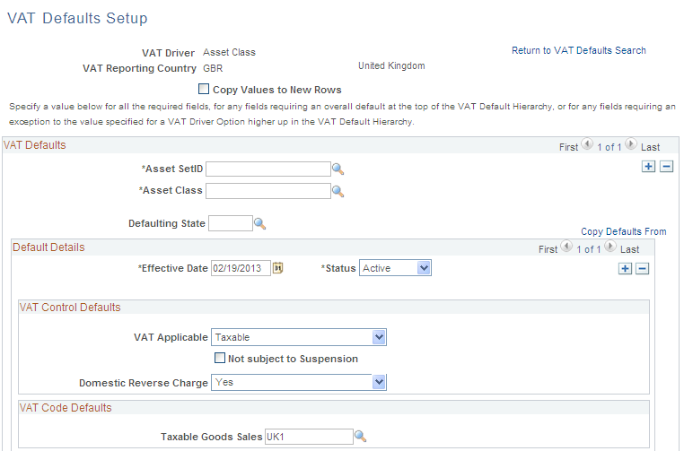

VAT Defaults Setup Page
Use the VAT Defaults Setup page (VAT_DEFAULTS_DTL) to enter VAT default information.
The fields displayed, default values, and data required vary based on the VAT driver and VAT driver keys entered.
Image: VAT Defaults Setup page (1 of 2)
This example illustrates the fields and controls on the VAT Defaults Setup page (1 of 2). You can find definitions for the fields and controls later on this page.
Image: VAT Defaults Setup page (2 of 2)
This example illustrates the fields and controls on the VAT Defaults Setup page (2 of 2). You can find definitions for the fields and controls later on this page.
Note: The VAT default fields that appear vary based on the VAT driver. In addition, the VAT default data is based on the VAT driver and VAT driver keys used to access this page.
Use the page to specify a value for all the required fields, for any fields requiring an overall default at the top of the VAT default hierarchy, or for any fields requiring an exception to the value specified for a VAT driver higher up in the VAT default hierarchy.
You can insert rows for any or all of the VAT driver keys as well as the VAT country or state. You can also delete any existing rows.
Note: The remaining fields on the page vary based on the combination of VAT driver and VAT driver keys. See the section on VAT fields for details of the fields that appear and the VAT drivers for which they appear in hierarchy order.

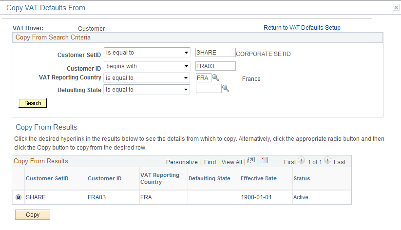

Copy VAT Defaults Setup Page
Use the Copy VAT Defaults Setup page (VAT_DEFAULT_DTLSEC) to view the details from which to copy.
Image: Copy VAT Defaults From page
This example illustrates the fields and controls on the Copy VAT Defaults From page. You can find definitions for the fields and controls later on this page.

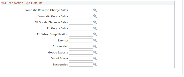

VAT Transaction Types Defaults
VAT transaction types classify and categorize transactions at a more detailed level for both VAT reporting and accounting. The following table lists the available types of VAT transaction type defaults and the VAT drivers for which they are available. Select the most frequently used VAT transaction type for each VAT Transaction Type field at the highest level of the VAT default hierarchy, and then specify exceptions at the lower levels of the hierarchy as necessary.
Default VAT Transaction Type Field
Field Description
VAT Driver Option
Domestic Goods Purchases
Purchase of goods within the same country.
VAT Entity Registration (required)
PO Options
AP Options
Expenses Business Unit
Voucher Origin
Voucher Control Group
Supplier
Supplier Location
Item Category
Expense Type
Item
Domestic Goods Reverse Charge Purchases
Purchases of goods within the same country that are subject to the domestic reverse charge.
PO Options
AP Options
Voucher Origin
Supplier
Supplier Location
Item Category
Item
Domestic Goods Sales
Sale of goods within the same country.
AR Options
Order Management Business Unit
Billing Business Unit
Asset Management Business Unit
Bill Type
Bill Source
Customer
Customer Location
Asset Class
Sales Line Identifier Group
  • Product group
  • Charge code VAT group
  • Generic identifier group
  • CRM Service Type (CRM only)
  • Inventory Item Group (CRM only)
  • Product
  • Charge code
  • Discount code
  • Surcharge code
  • Inventory Item (CRM only)
  • Labor Type (CRM only)
Domestic Goods Reverse Charge Sales
Sales of goods within the same country that are subject to the domestic reverse charge.
AR Options
Bill Type
Bill Source
Customer
Customer Location
Asset Class
  • Product group
  • Product
  • Charge code
  • Discount code
  • Surcharge code
Domestic Services Purchases
Purchase of services within the same country.

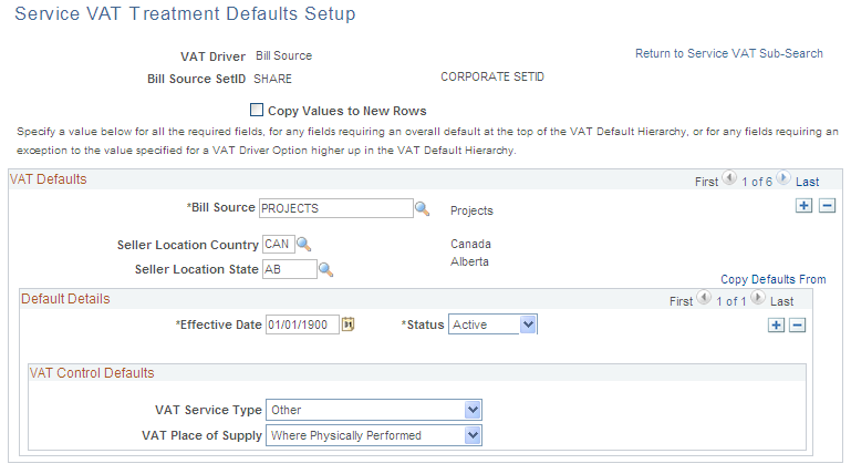

Accessing the Service VAT Treatment Defaults Setup Page
To access the Service VAT Treatment Defaults Setup page:
  1. Navigate to Setup Financials/Supply Chain, Common Definitions, VAT and Intrastat, Value Added Tax, Service VAT Treatment Defaults.
    A search window appears.
  2. Select the VAT Driver that you want to maintain or set up and click Search.
    The VAT drivers listed are based on the installed applications. A Service VAT Treatment Defaults Sub-Search page appears.
    Note: The VAT drivers table provided previously in this section lists the VAT drivers on which you can specify service VAT treatment defaults.
  3. Enter any or all of the VAT driver keys that appear, the supplier's location country, and supplier's location state, as applicable, and then click Search.
    The system accesses the Service VAT Treatment Defaults Setup page and displays all service VAT treatment default data for the rows matching the VAT driver selected and VAT driver keys entered.
Use the Service VAT Treatment Defaults Setup page (VAT_DEFAULTS_DTL) to enter VAT default information for service VAT treatment.
Image: Service VAT Treatment Defaults Setup page showing the Bill Source driver
You can insert rows for any or all of the VAT driver keys as well as the supplier's location country or state. You can also delete any existing rows.
Copy Service VAT Treatment Defaults From Page
Use the Copy Service VAT Treatment Defaults From page (VAT_DFLT_SRCH_COPY) to copy data from an existing VAT default or service VAT treatment default setup to the current VAT driver and driver keys combination.

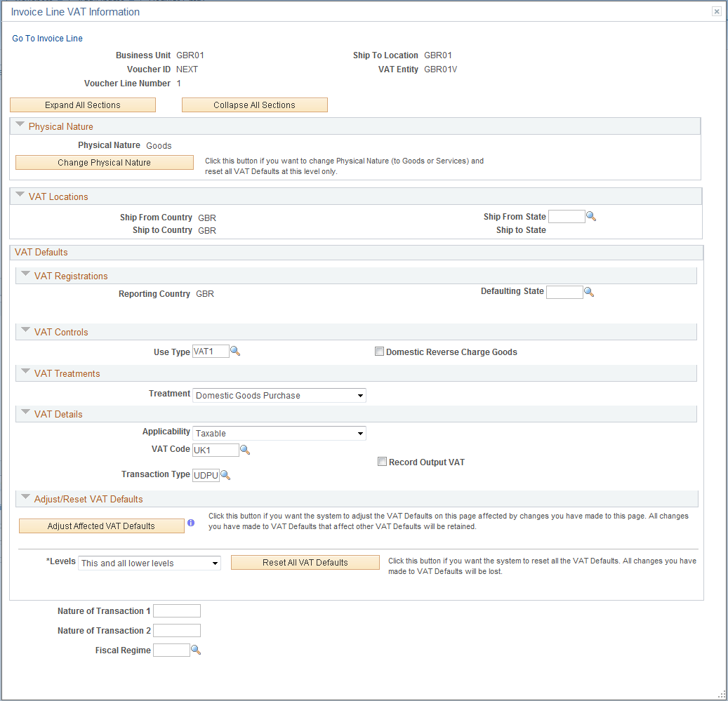

Image: Invoice Line VAT Information page (1 of 2) accessed from the voucher line in PeopleSoft Payables
This example illustrates the fields and controls on the Invoice Line VAT Information page (1 of 2) accessed from the voucher line in PeopleSoft Payables. You can find definitions for the fields and controls later on this page.

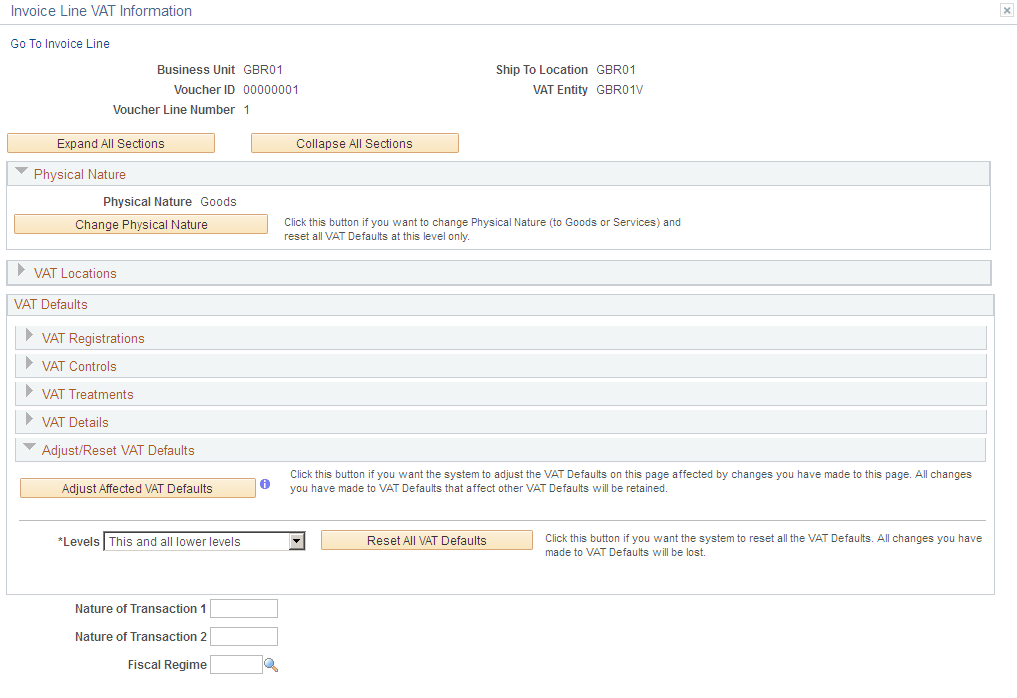

Image: Invoice Line VAT Information page (2 of 2) showing all the sections expanded
This example illustrates the fields and controls on the Invoice Line VAT Information page (2 of 2) showing all the sections expanded. You can find definitions for the fields and controls later on this page.
Selecting or deselecting the Reverse Charge Goods check box and then clicking the Adjust button adjusts the VAT Treatment, Record Output VAT, and other related defaults.
You can override default VAT settings on individual transactions from the applicable PeopleSoft application pages. For example, you can override VAT settings for a voucher line by accessing the Invoice Line VAT Information page from the Voucher component. While the fields that appear on this page may vary based on the application, the page acts in much the same way.
Note: The VAT defaults appear in descending order of effect. If you change any settings on this page, you should work from the top of the page to the bottom, clicking the Adjust Affected VAT Defaults button as appropriate.
Adjust/Reset VAT Defaults
