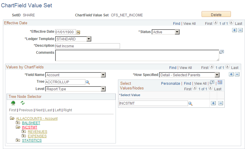

ChartField Value Set Page
Use the ChartField Value Set page (CF_VALUE_SET) to define sets of ChartField values to be used for such things as closing, commitment control budget close, equitization, and consolidation processing.
Image: ChartField Value Set page
This example illustrates the fields and controls on the ChartField Value Set page. You can find definitions for the fields and controls later on this page.
In the Values by ChartFields group box, identify the values to be included in this value set.
