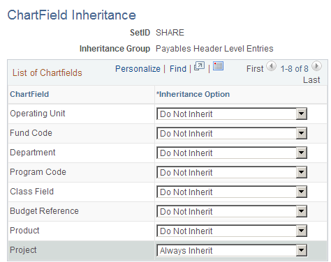

ChartField Inheritance Page
Use the ChartField Inheritance page (CF_INHERIT) to maintain the Inheritance Options for an Inheritance Group.
Image: ChartField Inheritance page
This example illustrates the fields and controls on the ChartField Inheritance page. You can find definitions for the fields and controls later on this page.
Refer to the documentation for ChartField Inheritance for each product for variations in functionality or information specific to that product.
