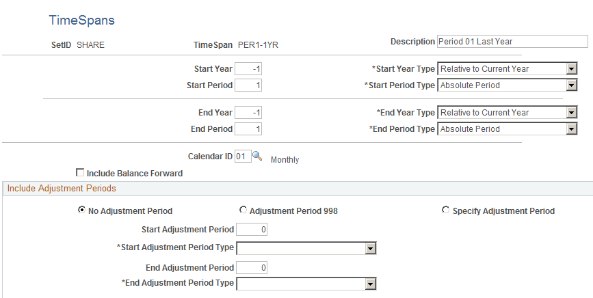

TimeSpans Page
Use the TimeSpans page (TIME_SPAN) to define TimeSpans for ledger reports or inquiries.
Image: TimeSpans page
This example illustrates the fields and controls on the TimeSpans page. You can find definitions for the fields and controls later on this page.
TimeSpans page
