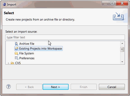

  1. In Eclipse, with your Workspace open, select File->Import and choose Existing Projects into Workspace. Click Next.

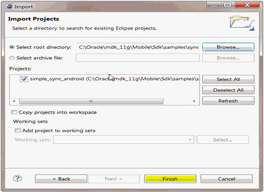

  2. In the project location point to
    <MDK_ROOT>\Mobile\Sdk\samples\Sync\android\simple_sync_android
    Replace <MDK_ROOT> with the full path where Oracle Database Mobile Server Development Kit was installed. In Figure 4-2, for example, it is C:\oracle\mdk_11g
    Figure 4-2 Select Root Directory for Eclipse Project
    Description of Figure 4-2 follows
    Description of "Figure 4-2 Select Root Directory for Eclipse Project"
  3. Click on "Browse…" button which should find the project files. Select the simple_sync_android project and click Finish. The simple_sync_android project is now imported into your Eclipse Workspace.

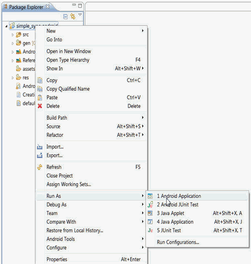

  5. Run/Debug the simple_sync_android on a device emulator. After a successful build, to run the application, right click on the “simple_sync_android” project. Go to “Run As” item, and select “Android Application.” This will bring up the Android Emulator, where you should find “Mobile Sync” application.

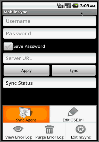

  6. Once the Android emulator is loaded, the mSync application will be started. To sync with a Mobile Server, provide a sync client's authentication information, the Mobile Server's http url (for example, myhost: 8090) and select the "Sync" button.
    Several menu options are available when you select the "Device Menu" button. For more information, see Table 4-1.
    Figure 4-4 Synchronization UI
    Description of Figure 4-4 follows
    Description of "Figure 4-4 Synchronization UI"
    Table 4-1 Menu Options for "Device Menu" Button
    Button Functions
    Sync Agent
    Brings up the automatic Sync Agent screen
    Edit OSE.ini
    Allows users to modify contents of parameter file, OSE.ini
    View Error Log
    View the contents of the sync error log
    Purge Error Log
    Remove all contents from the sync error log
    Exit mSync
    Exit the application and terminate the mSync process.
