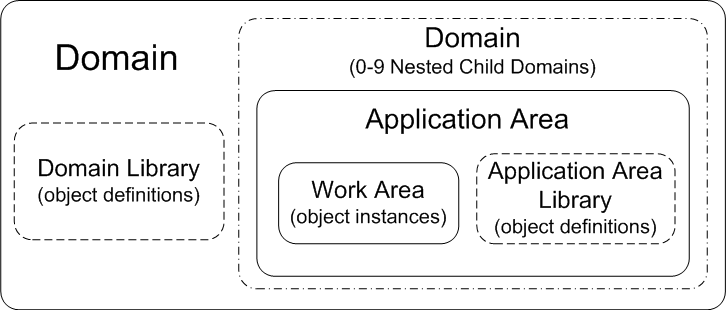

Oracle LSH can display a maximum of 200 rows at a time by default, so if you define more than 200 Domains within a Domain, or Application Areas within a Domain, or Work Areas within an Application Area, or objects within either an Application Area or Work Area, you get an error. Therefore Oracle recommends that you design your organizational structure to avoid this problem. Alternatively, it is possible to reset an Oracle Applications profile to display more than 200 rows at a time; however this affects all your Oracle Applications.Also, keep container and Program names short if you are using an integrated development environment (IDE) such as SAS. Oracle LSH identifies objects in the IDE by their full pathname and the maximum length allowed for the full pathname is 256 characters. For further information see "Naming Objects" in the Oracle Life Sciences Data Hub Application Developer's Guide.
The relationship among the containers is described in the following sections and shown in Figure 3-1, "Oracle LSH Organizational Structure" below. The libraries in both Domains and Application Areas are shown with dotted lines because a Library is not a container that must be defined. A library simply consists of all the object definitions contained directly in either the Domain or the Application Area.
The Domain container inside the Domain container is shown in a different type of dotted line because you can choose to have no child Domains or up to nine (9) levels of nested Domains. See "Domains" for further information.
Figure 3-1 Oracle LSH Organizational Structure
For ideas on how to use this structure, see "Examples of Organization Design".

A Domain is the top-level container in Oracle LSH. Domains have two purposes, and any one Domain can be used for one or both of these purposes:
Organizer. A Domain can contain child Domains and/or Application Areas. You can use a Domain to organize these other containers—child Domains and Application Areas—into logical groups. For example, you might create a Domain for a particular drug project and one Application Area within it for each clinical trial in the project. Alternatively you could create a Domain for a project, create a child Domain within the project Domain for each trial in the project, and create an Application Area for each report set. See "Examples of Organization Design" for other examples.
Library. A Domain can contain a library of object definitions. See "Domain Libraries".
Even if the Domain's only purpose is to store library definitions, you may want to include an Application Area containing a Work Area in order to install and test the definitions within the Domain before promoting them to the Domain library.
You can define any number of Domains and any number of Application Areas within a Domain.
Nested Domains Whether or not you can define Domains within Domains, and if so, how many levels of Domains, depends on your setting for the Domain Nest Value profile; see "Setting Profile Values" in the Oracle Life Sciences Data Hub System Administrator's Guide for further information. The allowed values range from zero (no nested Domains; a single level of Domains that can contain Application Areas and object definitions only) and nine (9 levels of nested Domains). The default value is two (2).
The Domain Nest Value setting does not affect the number of Domains you can define at the same level within a parent Domain. You can define any number of sibling Domains at a given level.

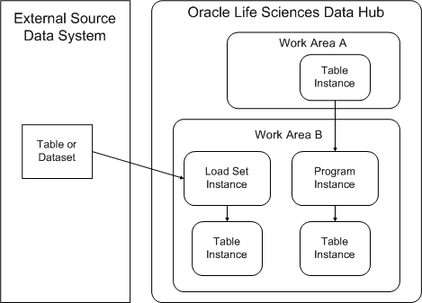

After a Work Area is installed, you can populate its underlying database schema with data in two basic ways:
To load data from an external system, define, install, and run a Load Set (see "Loading Data") in the Work Area.
To operate on data already stored in Oracle LSH, define a Program in the Work Area and map each of its source Table Descriptors to a Table instance in any Work Area in Oracle LSH (see "Operating on Data"). Then install and run the Program.
Therefore it is not necessary to load data into the same Work Area where it will be processed. You can load a set of data to one Work Area and read it from a Program in any Work Area afterward. Figure 3-2 represents data flow options graphically.

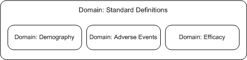

You can use child Domains to organize definitions by type. For example, create a child Demography Domain to store demography-related Tables, Programs, Report Sets, and Data Marts. Create an Adverse Events Domain and an Efficacy Domain, and so on.
You can create these definitions as needed in other Domains and move them to the standard definition Domain when they are ready, or you can create Application Areas and Work Areas inside these Domains for the purpose of creating and testing standard definitions.When you define and run a Load Set for the Oracle Clinical Global Library, the adapter automatically creates an Oracle LSH Domain into which it puts Oracle LSH Variables, lists of values, and Tables that it converts from user-defined Oracle Clinical Questions, DVGs, and Question Groups. For further information, see "Defining Load Sets" in the Oracle Life Sciences Data Hub Application Developer's Guide.

You can define any number of Domains, and each Domain can contain a library of object definitions of any validation status and/or any number of Application Areas. The number of levels of child Domains allowed is determined by your setting of the Domain Nest Value profile; see "Nested Domains" and "Setting the Maximum Number of Nested Domains" in the Oracle Life Sciences Data Hub System Administrator's Guide for further information.
Considerations Take the following into consideration:
Domains are an important part of the security and classification systems; read Chapter 4, "Designing a Security System" and Chapter 5, "Designing a Classification System for Searching and Browsing" before you reach a decision on Domain usage.
You can browse objects in only one Domain at a time in the Oracle LSH user interface. However, you can search for objects in any Domain at any time.
You must decide the number and purpose of Application Areas in each Domain.
You can define any number of Application Areas in a Domain.
Considerations The business purpose of each Application Areas contained in a Domain should be a part of the business purpose of the Domain.
For example, if the purpose of the Domain is to contain all the data for a drug project, the purpose of each Application Area might be to contain all the data for a particular study that is part of that project.
If the purpose of the Domain is to contain standard Report Sets, the purpose of each Application Area might be to contain a particular Report Set.
See also "Alternative Usage of Application Areas or Child Domains".
For normal usage, you need to create one Work Area in each Application Area.
Considerations In standard Application Area usage, as time goes on you will clone this Work Area to create a Quality Control Work Area, and then clone the QC Work Area to create a Production Work Area.
It is possible to use an Application Area for object definition storage without a Work Area. However, even if you are using the Application Area for definition storage, you may want a Work Area to install and test the definitions. See "Alternative Usage of Work Areas".
