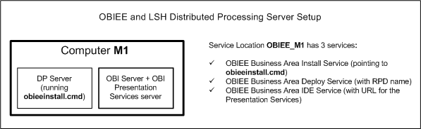

By default when you install the BI Server, a Presentation Server is also installed on the same computer. You must install the Oracle LSH Distributed Processing (DP) Server on this computer as well. All Business Areas defined in Oracle LSH then point to this Presentation Server. Oracle LSH merges the .rpd files for all Business Areas into a single large .rpd file.
In Oracle LSH you must define a service location for the BI Server computer; see "Defining Service Locations". Figure 11-1 shows the setup of a single-computer configuration.
You must define all three OBIEE Services for the service location; see "Defining Services" for more detailed instructions.
OBIEE Business Area Install Service. In the Execution Command field of this service, enter the path of the obieeinstall.cmd script; for example: C:\LSH_DP_SERVER\obiee\obieeinstall.cmd
If you are using OBIEE 10g, the file names have "10g" appended: obieeinstall10g.cmd and obieedeploy10g.cmdNote:
During installation this script should have been copied into the DP Server Home directory or a subdirectory of it.OBIEE Business Area Deploy Service. In the Execution Command field of this service, enter the path of the obieeinstall.cmd script; for example: C:\LSH_DP_SERVER\obiee\obieedeploy.cmd
In the Details field, enter database connection information and the name of the .rpd file you want to use on the Oracle BI Presentation Server; for example: dsn=abc123,callinterface=OCI10G,RPD=LSH_MASTER
. If you are using OBIEE 11g, add ver=11g

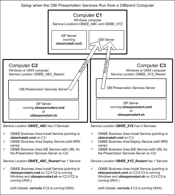

If you want to install the Oracle BI Presentation Server on a UNIX machine, or on an additional Windows machine, you can install just the Oracle BI Presentation Server and the Oracle LSH DP Server on the second machine, without the Oracle BI Server as shown in Figure 11-2.
You can choose to have either a single, merged .rpd file or a different one for each Presentation Service instance. In either case, multiple Business Areas can use the same Presentation Server.
Define a pair of service locations for each Presentation Server computer: one on the Presentation Services computer ending in _RESTART
and one on the BI Server computer with the same name except without the _RESTART
string; see "Defining Service Locations".
Edit the DP Server Start script on each computer with the exact name you give the service location. Instructions are in the Oracle Life Sciences Data Hub Installation Guide.
Do not use spaces, slashes, or special characters such as single quotes (') in the service location name. This may cause problems when you define a remote location and connection to password-protect the .rpd file.In Oracle LSH you must define a pair of service locations, one with services running on the BI Server computer and the other with services running on the Presentation Services computer, for each separate Presentation Services computer.
Service Location Name The name of the service location for the Presentation Services computer must be the same as the corresponding service location for the BI Server plus the string _RESTART
Do not use spaces, slashes, or special characters such as single quotes (') in the service location name. This may cause problems when you define a remote location and connection to password-protect the .rpd file.When Definers create a new OBIEE Business Area, they must select a service location to use. The drop-down list displays all OBIEE service locations that do not end in _RESTART
For example, as shown in Figure 11-2, the service location and service requirements when the BI Server and Presentation Server are on different computers are:
Give the first service location, which must be for a Windows computer, a name such as OBIEE_ABC
and define all three OBIEE services for it:
OBIEE Business Area Install Service. In the Execution Command field of this service, enter the complete directory path and filename for the Windows execution command script on the BI Server computer; for example : C:\LSH_DP_SERVER\obiee\obieeinstall10g.cmd
OBIEE Business Area Deploy Service. In the Execution Command field of this service, enter the complete directory path and filename for the Windows execution command script on the BI Server computer; for example : C:\LSH_DP_SERVER\obiee\obieeinstall10g.cmd
In the Details field, enter database connection information and the name of the .rpd file you have defined for the Oracle BI Presentation Server; for example: dsn=ilpcr211,callinterface=OCI10G,RPD=Study02
OBIEE Business Area IDE Service. In the Execution Command field of this service, enter the Presentation Services URL, for example: http://C2:9704/analytics/saw.dll?Answers
Give the second service location, which can be for either a Windows or UNIX computer, a name that is the same as the first service location plus the string _RESTART
; for example, OBIEE_ABC_RESTART
. Define one service for this service location: the OBIEE Business Area Install Service.
In the Execution Command field of this service, enter the complete directory path of the correct restart (not install) execution command script for the operating system; for example, on Windows:
C:\LSH_DP_SERVER\obiee\obieerestart10g.cmd
or on UNIX:
/slot/ems1/appmgr/lshdpserver/obiee/obieepsrestart10g.sh
If the Presentation Server is a UNIX computer, enter os=unix
in the Details field of this service.

Each Presentation Server must be installed on a different computer and has a different URL. You can use this setup to control what users can see in OBIEE. For example:
If you have only one Business Area using a particular Presentation Server, users launching OBIEE with that URL can see only the Subject Area that corresponds to that Business Area. You can include the Subject Area in the URL so that users go directly to the Subject Area page; for example: http://
srv:port
/analytics/saw.dll?Answers&SubjectArea=X
You can organize your Business Areas so that only related Business Areas use the same Presentation Server; for example, all studies in a single project have a Business Area, and there is another Business Area for the project as a whole. Users launching OBIEE with that URL can see only the Subject Areas related to that project, and can see data only for the Subject Areas that correspond to Business Areas on which they have View privileges.
