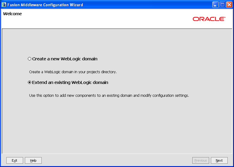

  1. Start Configuration Wizard and then select Extend an existing WebLogic Domain in the Welcome screen (Figure 3-3). Click Next. The Select a WebLogic Domain Directory screen appears.

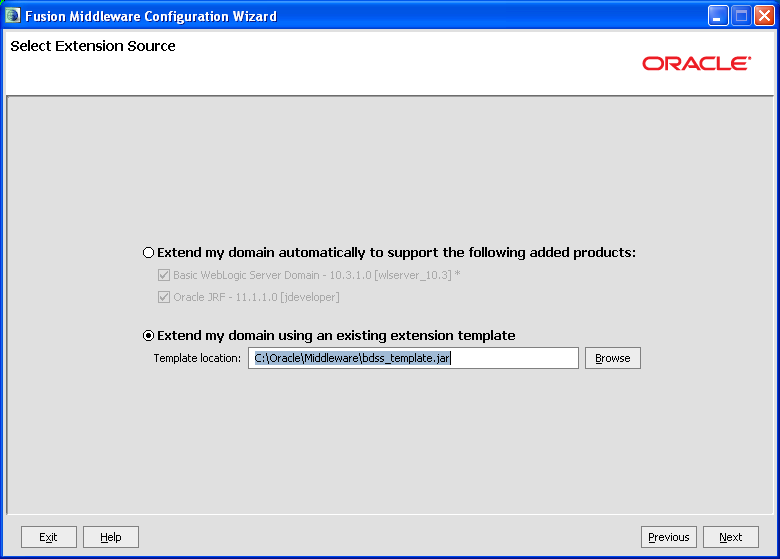

  2. Select any domain that has JMS installed and then click Next. The Select Extension Source screen appears.
  3. Select Extend my domain using an existing extension template.

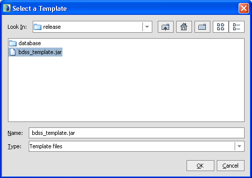

  4. Using the Select a Template dialog, locate bdss_template.jar (Figure 3-4) and then click OK.
    Figure 3-4 Selecting bdss_template.jar
    Select bdss_template.jar
  5. In the Select Extension Source dialog, select BDSS template.jar and then click Next.

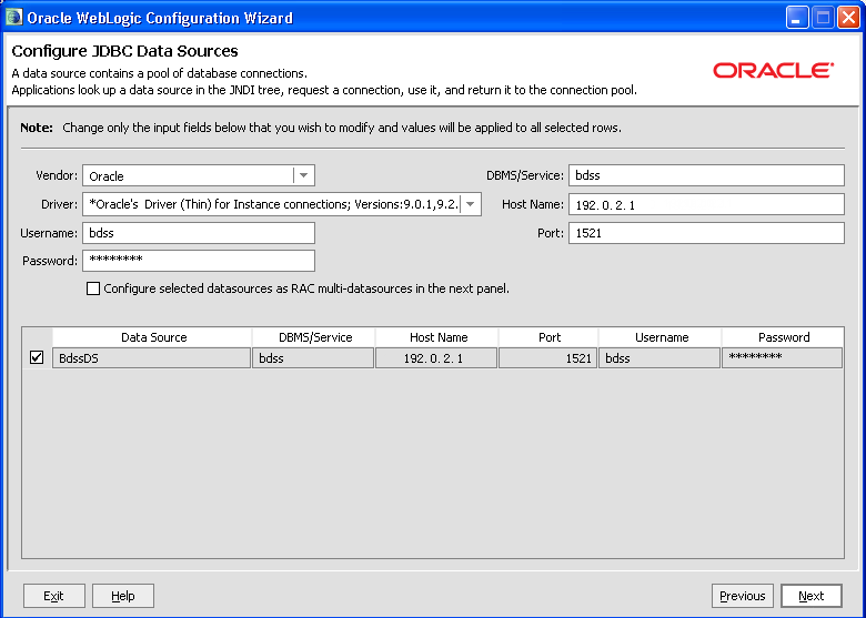

  6. In the Configure JDBC DataSource page (Figure 3-6), enter the connection information. The user name must be bdss. Click Next. The Test JDBC Data sources screen appears.
    Figure 3-6 Configuring the JDBC Data Source
    Selecting JDBC sources.

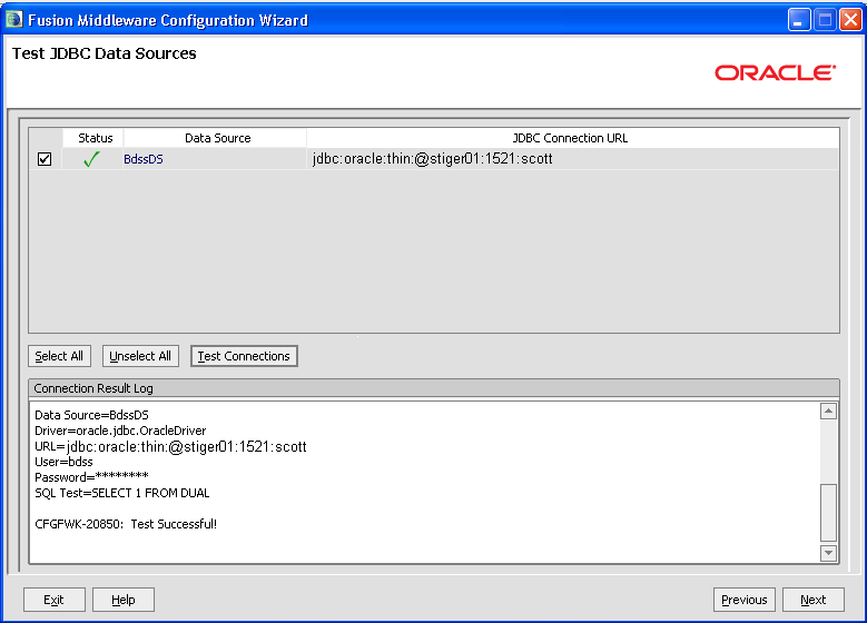

  7. Click Test Connections. Click Next after Configuration Wizard generates a Test Successful! message (Figure 3-7). The Run Database Scripts screen appears.
    Figure 3-7 Testing the JDBC Connections

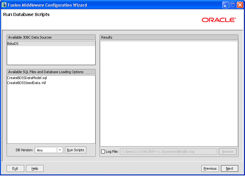

  8. In the Run Database Scripts page (Figure 3-8), click Run Scripts.The CreateBDSSDataModel.sql script creates the database tables and triggers and the BDSSSeedData.sql script populates the database with sample data for the domains.
    Figure 3-8 Creating the Database Tables and Seeding Data
    Select model and data scripts

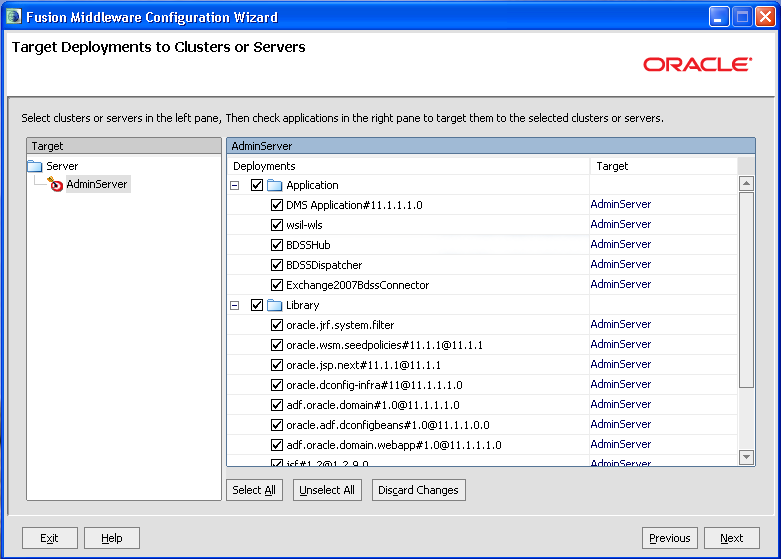

  9. Continue to the Target Deployments to Clusters and Servers screen (Figure 3-9).
    The Dispatcher, the Hub, and the Exchange 2007 Connector are deployed by default. If needed, select Deployments and Services in the Select Optional Configuration screen that follows the Run Database Scripts screen. After you select this option, you then select the applications to deploy. This optional configuration enables scalability by allowing you to deploy each component on a different WebLogic Server.
    Figure 3-9 Selecting BDSS Components
    Select BDSS components
  10. Select the BDSS components to deploy and then click Next. By default, the wizard deploys the Dispatcher, the Hub, and the Exchange 2007 Connector. The Configuration Summary screen appears (Figure 3-10).

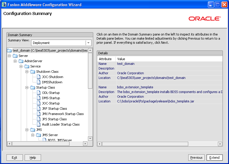

    Figure 3-10 The Configuration Summary Screen
  11. Review the installed components. Click Previous to return to the Target Deployments to Clusters or Services and change your selection.

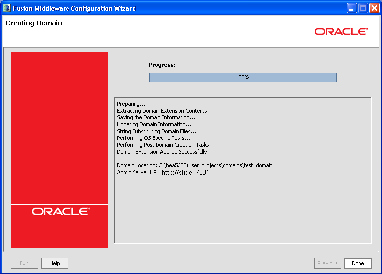

  12. Click Next. The Configuration Manager creates the domain. When the progress indicator on the Creating Domain screen completes (Figure 3-11). Click Done.
    Figure 3-11 The Create Domain Screen
    Completing the domain.
