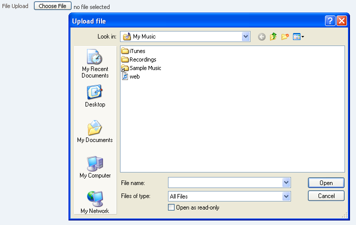

The inputFile component is a component that can be used to upload a file. Any form that contains this component must have usesUpload set to true. The "value" property of an inputFile component will be set to an instance of the org.apache.myfaces.trinidad.model.UploadedFile class when a file is uploaded in single file mode (with the appropriate ValueChangeEvent delivered.) The property will be set to an instance of List<org.apache.myfaces.trinidad.model.UploadedFile> when the component is in multiple file upload mode. Before using the component, developers must install the Trinidad filter.
The component supports custom converters to transform the org.apache.myfaces.trinidad.model.UploadedFile. To archive this, the the getAsObject() method is invoked, where the the String value is a key, which must be used to query the actual uploaded file from the request Map:
public Object getAsObject(FacesContext context, UIComponent component, String fileKey)
UploadedFile file = (UploadedFile)context.getExternalContext().getRequestMap().get(fileKey);
// do transformation
return file;
There is a maximum size for downloaded files. For further information, see Configuration (The Configuration page comes from the Apache Trinidad site and therefore refers to tr: components. Simply replace tr: with af: for ADF Faces).
The attributes "disabled", "immediate", "readOnly", "required", "requiredMessageDetail", "value" are not settable from the client for security reasons.
<af:form usesUpload="true">
<af:inputFile columns="10"
valueChangeListener="#{backing.fileUploaded}"/>
</af:form>
