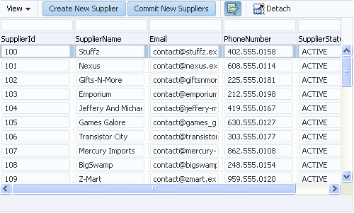

You can create a table that allows the user to edit information within the table, and then commit those changes to the data source. To do this, you use operations that can modify data records associated with the returned collection (or the data control itself) to create command buttons, and place those buttons in a toolbar in the table. For example, the table in the browse.jspx page has a button that allows the user to remove a product. While this button currently causes a dialog to display that allows the user to confirm the removal, the button could be bound to a method that directly removes the product.
Tip:
To create a table that allows you to insert a new record into the data store, see Section 4.4, "Creating an Input Table."
As with editable forms, it is important to note that the ADF Model layer is not aware that any row has been changed until a new instance of the collection is presented. Therefore, you need to invoke the execute operation on the accessor iterator in order for any changes to be committed. For more information, see Section 2.4.4, "What You May Need to Know About Iterator Result Caching."

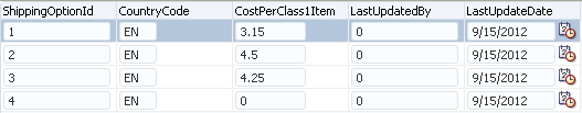

When you decide to use editable components to display your data, you have the option of having the table displaying all rows as editable at once, or having it display all rows as read-only until the user double-clicks within the row. Figure 4-3 shows a table whose rows all have editable fields. The page is rendered using the components that were added to the page (for example, inputText, inputDate, and inputNumberSpinbox components).
Figure 4-2 shows the same table, but configured so that the user must double-click (or single-click if the row is already selected) a row in order to edit or enter data. Note that outputText components are used to display the data in the nonselected rows, even though the same input components as in Figure 4-3 were used to build the page. The only row that actually renders those components is the row selected for editing.
For more information about how ADF Faces table components handle editing, see the "Editing Data in Tables, Trees, and Tree Tables" section of the Oracle Fusion Middleware Web User Interface Developer's Guide for Oracle Application Development Framework.

Creating an editable table is similar to creating a form used to edit records. Action bindings are created for the operations dropped from the Data Controls panel. For more information, see Section 3.6.2, "What Happens When You Use Methods to Change Data."
You can create a table that allows users to insert a new blank row into a table and then add values for each column (any default values set on the corresponding entity object will be automatically populated).
When you create an input table, you want the user to see the new blank row in the context of the other rows within the current row set. To allow this insertion, you need to use the create operation associated with the accessor for the collection. For example, to create a table that allows users to create new suppliers, you would create a table from the supplierFindAll accessor collection and then add a button using the create operation for the supplierFindAll accessor collection.
Because the create operation only creates a row in the cache, you also need to add a button that actually merges the newly created row into the collection. Figure 4-7 shows how this table might look with a new row created.

You need to create an editable table, as described in Section 4.3, "Creating an Editable Table."
From the Data Controls panel, drag the create operation associated with the dropped collection and drop it as a toolbar button into the toolbar.
Tip:
You may want to change the ID to something more recognizable, such as Create. This will make it easier to identify when you need to select it as the partial trigger.
In the Structure window, select the table component.
In the Property Inspector, expand the Behavior section, click the dropdown menu for the PartialTriggers attribute, and select Edit.
In the Edit Property dialog, expand the toolbar facet for the panelCollection component and then expand the toolbar that contains the Create command component. Select that component and shuttle it to the Selected panel. Click OK. This sets that component to be the trigger that will cause the table to refresh.
Create a button that allows the user to merge the new object(s) into the collection. From the Data Controls panel, drag the merge method associated with the collection used to create the table, and drop it as a toolbar button or link into the toolbar.
Tip:
If you will want the user to be able to continue updating the row after it is persisted, then you should create the button using the persist method instead. For more information, see Section 3.6.3, "What You May Need to Know About the Difference Between the Merge and Persist Methods."
Figure 4-8 shows merge method for the Suppliers collection.

Example 4-6 shows the code added to the JSF page that provides partial page rendering, using the Create Supplier and Commit New Suppliers command toolbar button as the triggers to refresh the table.
Example 4-6 Partial Page Trigger Set on a Command Button for a Table
<af:form id="f1">
<af:panelCollection id="pc1">
<f:facet name="menus"/>
<f:facet name="toolbar">
<af:toolbar id="t2">
<af:commandToolbarButton actionListener="#{bindings.Create.execute}"
text="Create New Supplier"
disabled="#{!bindings.Create.enabled}"
id="ctb1"/>
actionListener="#{bindings.mergeSuppliers.execute}"
text="Commit New Suppliers"
disabled="#{!bindings.mergeSuppliers.enabled}"
id="ctb2"/>
</af:toolbar>
</f:facet>
<f:facet name="statusbar"/>
<af:table value="#{bindings.suppliersFindAll.collectionModel}"
var="row" rows="#{bindings.suppliersFindAll.rangeSize}"
emptyText="#{bindings.suppliersFindAll.viewable ? 'No data to
display.' : 'Access Denied.'}"
fetchSize="#{bindings.suppliersFindAll.rangeSize}"
rowBandingInterval="0"
selectedRowKeys=
"#{bindings.suppliersFindAll.collectionModel.selectedRow}"
selectionListener=
"#{bindings.suppliersFindAll.collectionModel.makeCurrent}"
rowSelection="single" id="t1"
partialTriggers="::ctb1 ::ctb2">
<af:column sortProperty="supplierId" sortable="false"
headerText=
"#{bindings.suppliersFindAll.hints.supplierId.label}"
id="c6">
<af:inputText value="#{row.bindings.supplierId.inputValue}"
label="#{bindings.suppliersFindAll.hints.supplierId.label}"
required="#{bindings.suppliersFindAll.hints.supplierId.mandatory}"
columns="#{bindings.suppliersFindAll.hints.supplierId.displayWidth}"
maximumLength="#{bindings.suppliersFindAll.hints.supplierId.precision}"
shortDesc="#{bindings.suppliersFindAll.hints.supplierId.tooltip}"
id="it4">
<f:validator binding="#{row.bindings.supplierId.validator}"/>
<af:convertNumber groupingUsed="false"
pattern="#{bindings.suppliersFindAll.hints.supplierId.format}"/>
</af:inputText>
</af:column>
</af:table>
</af:panelCollection>
</af:form>
When the button bound to the create operation is invoked, the action executes, and a new instance for the collection is created as the page is rerendered. Because the button was configured to be a trigger that causes the table to refresh, the table redraws with the new empty row shown at the top. When the user clicks the button bound to the merge method, the newly created rows in the row set are inserted into the database. For more information about partial page refresh, see the "Rendering Partial Page Content" chapter in the Oracle Fusion Middleware Web User Interface Developer's Guide for Oracle Application Development Framework.
If your table columns allow sorting, and the user has sorted on a column before inserting a new row, then that new row will not be sorted. To have the column sort with the new row, the user must first sort the column opposite to the desired sort, and then re-sort. This is because the table assumes the column is already sorted, so clicking on the desired sort order first will have no effect on the column.
For example, say a user had sorted a column in ascending order, and then added a new row. Initially, that row appears at the top. If the user first clicks to sort the column again in ascending order, the table will not re-sort, as it assumes the column is already in ascending order. The user must first sort on descending order and then ascending order.
If you want the data to automatically sort on a specific column in a specific order after inserting a row, then programmatically queue a SortEvent after the commit, and implement a handler to execute the sort.
