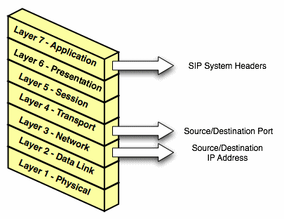

Figure 5-1 shows the OSI model layers that are typically affected by the network configuration requirements for the Converged Application Server deployment.
Layer 3 (Network) and Layer 4 (Transport) contain the source or destination IP address and port numbers for both outgoing and incoming transport datagrams. Layer 7 (Application) may also be affected because the SIP protocol specifies that certain SIP headers include addressing information for contacting the sender of a SIP message.

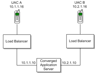

When using multiple NICs to support different subnets, you must configure multiple network on the server for each different NIC as described in "Multihomed Servers Listening on Multiple Subnets".
The simplest multihome configuration enables a Converged Application Server instance to listen on all available NICs (physical NICs as well as logical NICs), sometimes described as IP_ANY. To accomplish this, you configure a single network channel and specify a channel listen address of 0.0.0.0.
See information about configuring engine servers to listen on any IP interface in the Converged Application Server Administrator's Guide.
Multiple NICs can also be used in engine tier servers to listen on multiple subnets. The most common configuration uses Converged Application Server to proxy SIP traffic from one subnet to another where no direct access between subnets is permitted. Figure 5-3 shows this configuration.
To configure the Converged Application Server instance in this scenario, you must define a separate network channel for each NIC used on the server machine. Example 5-1 shows the config.xml entries that define channels for the sample configuration.
Example 5-1 Sample Network Channel Configuration for NICs on Multiple Subnets

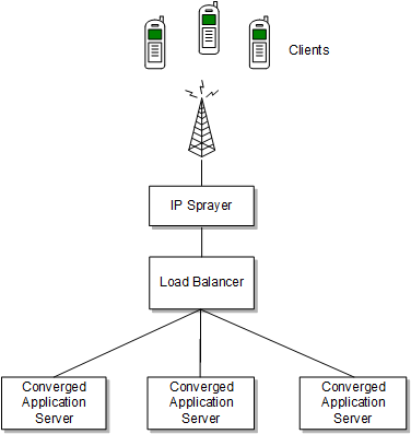

In the simplest scenario, a single IP sprayer gates access to a Load Balancer which distributes messages to a cluster of engines, as shown in Figure 5-4.
To configure Converged Application Server for use with a single IP sprayer, configure one or more network channels for each server, and configure the external address setting of each channel with the virtual IP address of the IP sprayer. The virtual IP address is the address exposed for the Converged Application Server installation to external clients.
In this configuration, Converged Application Server embeds the external address (or VIP) in SIP message system headers to ensure that clients can reach the cluster for subsequent replies.

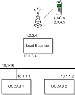

Figure 5-5 shows the sample network topology described in this section. A Converged Application Server cluster, consisting of engines WLSS 1 and WLSS 2, is configured on private IP network 10.1/16 (an internal 16-bit subnet). The cluster's public IP address is 1.2.3.4, which is the virtual IP address configured on the load balancer.
The User Agent, UAC A, with IP address 2.3.4.5 never sees the internal IP addresses configured for the Converged Application Server cluster. Instead, it sends requests to, and receives responses from 1.2.3.4.
The sections that follow discuss configuring the Converged Application Server cluster and load balancer for the example system.
The Converged Application Server cluster configuration specifies the public address as 1.2.3.4, and the public port as 5060 for each engine. The default route on both Converged Application Server engines points to the load balancer's 10.1/16 network interface: 10.1.3.4. The Converged Application Server (servers WLSS 1 and WLSS 2) routing table is shown in Example 5-2.
The load balancer is configured with a virtual IP address of 1.2.3.4, and two real servers, WLSS 1 and WLSS 2, having addresses 10.1.1.1 and 10.1.1.2, respectively. The load balancer also has an internal IP address of 10.1.3.4 configured on the 10.1/16 network. The UAC address, 2.3.4.5, is reachable from the load balancer by static route configuration on the load balancer. The load balancer routing table is shown in Example 5-3.

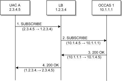

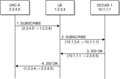

The default UDP NAT behavior for load balancers is to perform destination IP address translation in the public to private network direction, and source IP address translation in the private to public network direction. This means setting up destination address translation in the UAC to Converged Application Server (2.3.4.5 to 1.2.3.4) direction without source address translation, and source address translation in the Converged Application Server to UAC (10.1/16 to 2.3.4.5) direction without destination address translation.
Figure 5-6 illustrates the UDP packet flow for a SUBSCRIBE/200 OK transaction.
In the figure, the source and destination IP addresses of the UDP packets are shown under the message path arrow. In the UAC-to-Converged Application Server direction, the load balancer translates the destination IP address but not the source IP address. In the Converged Application Server-to-UAC direction, the load balancer translates the source IP address but not the destination IP address.
Example 5-4 shows the complete message trace (including IP and UDP headers, as well as the SIP payload) for the sequence from Figure 5-6.
Example 5-4 Complete SUBSCRIBE Message Trace

3 3.430903 10.1.1.1 2.3.4.5 SIP Status: 200 OK
Internet Protocol, Src: 10.1.1.1 (10.1.1.1), Dst: 2.3.4.5 (2.3.4.5)
User Datagram Protocol, Src Port: 42316 (42316), Dst Port: 9999 (9999)

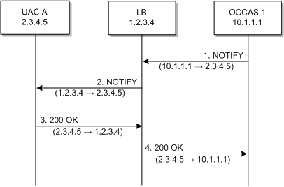

Figure 5-7 shows the message sequence that results from the Converged Application Server subsequently sending a NOTIFY request to the UAC:
As in the previous sequence, the IP address translation takes place in the Converged Application Server to UAC direction for the source IP address, and UAC to Converged Application Server direction for the destination IP address.
Note that this setup does not require the load balancer to maintain session state information or to be SIP-aware. The complete message trace from is shown in Example 5-5 below.
Example 5-5 Complete NOTIFY Message Trace
No. Time Source Destination Protocol Info

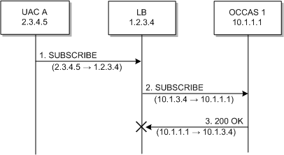

If NAT is performed on both the source (SNAT) and destination IP addresses, the configuration does not work because the load balancer usually relies on a specific destination port number value to be sent in responses to requests. That port number value is dictated by RFC 3261, and must come from the Via header, which presents a conflict with load balancer's NAT requirements. RFC 3261 requires that responses to SIP requests be sent to the IP address used to send the request (unless maddr is present in the Via, as described in "maddr-based Configuration"). Consequently, in step 3 in Figure 5-8 below, Converged Application Server sends a 200 OK response to the load balancer internal IP address (10.1.3.4) and port 5060. That response is then dropped.
Example 5-6 shows the complete message trace.
Example 5-6 Complete Failing SUBSCRIBE Message Trace

When the maddr parameter is present in the Via header, the response is sent to the IP address specified in the maddr rather than to the received IP address (even when SNAT is enabled).
In the example below, the UAC specifies a maddr set to 2.3.4.5 in the Via header. Consequently, the response from the SIP server makes it to the UAC.
Example 5-7 shows the complete message trace represented by Figure 5-9.
Example 5-7 Complete maddr Message Trace
1 1.425250 2.3.4.5 1.2.3.4 SIP Request: SUBSCRIBE sip:subscribe@1.2.3.4:5060
Internet Protocol, Src: 2.3.4.5 (2.3.4.5), Dst: 1.2.3.4 (1.2.3.4)
User Datagram Protocol, Src Port: 9999 (9999), Dst Port: sip (5060)
Session Initiation Protocol
Request-Line: SUBSCRIBE sip:subscribe@1.2.3.4:5060 SIP/2.0
Message Header
Via: SIP/2.0/UDP 2.3.4.5:9999;maddr=2.3.4.5;branch=1
From: sipp <sip:sipp@2.3.4.5>;tag=1
To: sut <sip:subscribe@1.2.3.4:5060>
Call-ID: 1-25923@2.3.4.5
Cseq: 1 SUBSCRIBE
Contact: sip:sipp@2.3.4.5:9999
Max-Forwards: 70
Event: ua-profile
Expires: 10
Content-Length: 0
2 2.426250 10.1.3.4 10.1.1.1 SIP Request: SUBSCRIBE sip:subscribe@1.2.3.4:5060
Internet Protocol, Src: 10.1.3.4 (10.1.3.4), Dst: 10.1.1.1 (10.1.1.1)
User Datagram Protocol, Src Port: 2222 (2222), Dst Port: sip (5060)
Message Header
Cseq: 1 SUBSCRIBE
Max-Forwards: 70
Event: ua-profile
Expires: 10
Content-Length: 0
Status-Line: SIP/2.0 200 OK
Message Header
To: sut <sip:subscribe@1.2.3.4:5060>;tag=82722c03
Content-Length: 0
Contact: <sip:app-12eomtm5h5f77@1.2.3.4:5060;transport=udp;wlsscid=1ae4479ac6ff71>

Figure 5-11 shows the NOTIFY message flow.
Note that while source address NAT is enabled for both directions (UAS to Converged Application Server and Converged Application Server to UA), the load balancer can correctly identify the destination address in Step 3 by relying on receiving responses on the same port number as the one used to send requests. This implies that the load balancer maintains state.
Example 5-9 shows the complete message trace from the figure.
Example 5-9 Complete Message Trace for rport NOTIFY
1 5.430952 10.1.1.1 2.3.4.5 SIP Request: NOTIFY sip:sipp@2.3.4.5:9999
Request-Line: NOTIFY sip:sipp@2.3.4.5:9999 SIP/2.0
Message Header
To: sipp <sip:sipp@2.3.4.5>;tag=1
Content-Length: 0
CSeq: 1 NOTIFY
Via: SIP/2.0/UDP 1.2.3.4:5060;wlsscid=1ae4479ac6ff71;branch=z9hG4bKc5e4c3b4c22be517133ab749adeece4e;rport
From: sut <sip:subscribe@1.2.3.4:5060>;tag=82722c03
Max-Forwards: 70
2 6.430952 1.2.3.4 2.3.4.5 SIP Request: NOTIFY sip:sipp@2.3.4.5:9999
Internet Protocol, Src: 1.2.3.4 (1.2.3.4), Dst: 2.3.4.5 (2.3.4.5)
User Datagram Protocol, Src Port: 2222 (2222), Dst Port: 9999 (9999)
Message Header
Content-Length: 0
CSeq: 1 NOTIFY
Max-Forwards: 70
3 7.431367 2.3.4.5 1.2.3.4 SIP Status: 200 OK
User Datagram Protocol, Src Port: 9999 (9999), Dst Port: (2222)
Message Header
To: sipp <sip:sipp@2.3.4.5>;tag=1;tag=1
CSeq: 1 NOTIFY
Contact: <sip:2.3.4.5:9999;transport=UDP
