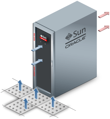

Airflow through Oracle Big Data Appliance is from front to back. See Table 2-1 for information about cooling and airflow.

Oracle Big Data Appliance is designed to function while mounted in a natural convection air flow. Follow these requirements to meet the environmental specification:
Ensure that the rack has adequate air flow.
Ensure that the rack has front-to-back cooling. The air inlet is at the front of the server, and the air outlet is at the rear.
Allow a minimum clearance of 91.4 cm (36 inches) at the front of the rack and 91.4 cm (36 inches) at the rear of the rack for ventilation.
Use perforated tiles, rated for 400 cubic feet per minute (CFM) per tile air flow, in front of the rack for cold air intake. The tiles can be arranged in any order in front of the rack, if cold air from the tiles can flow into the rack. Inadequate cold air flow could result in a higher inlet temperature in the servers due to exhaust air recirculation. Oracle recommends four floor tiles for Oracle Big Data Appliance.
Figure 2-5 shows a typical installation of the floor tiles for Oracle Big Data Appliance in a typical data center.
Figure 2-5 Typical Data Center Configuration for Perforated Floor Tiles
