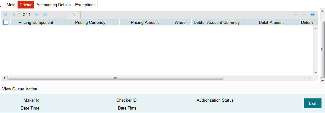

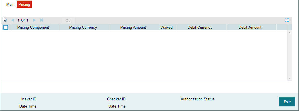

You can view the pricing details populated by system in this screen.
The following details are available:
Pricing Component
The system defaults the pricing component based on the Pricing code linked in Network Currency Preferences.
Pricing Currency
The system defaults the pricing currency.
Pricing Amount
The system defaults the pricing amount from Pricing Value Maintenance screen (PPDVLMNT) as applicable for the payment value date, Payment Source code and Debit Customer Service Model. However you can modify this value.
Note
Currency conversions related to charge computation are completed and final amount is populated component wise in the Pricing Tab.
Waived
The system defaults the waiver. However you can modify this value.
Note
If charge/tax is already waived at price value maintenances, then you cannot uncheck the waiver flag.
Debit amount
System defaults the customer debit amount for charge/tax.

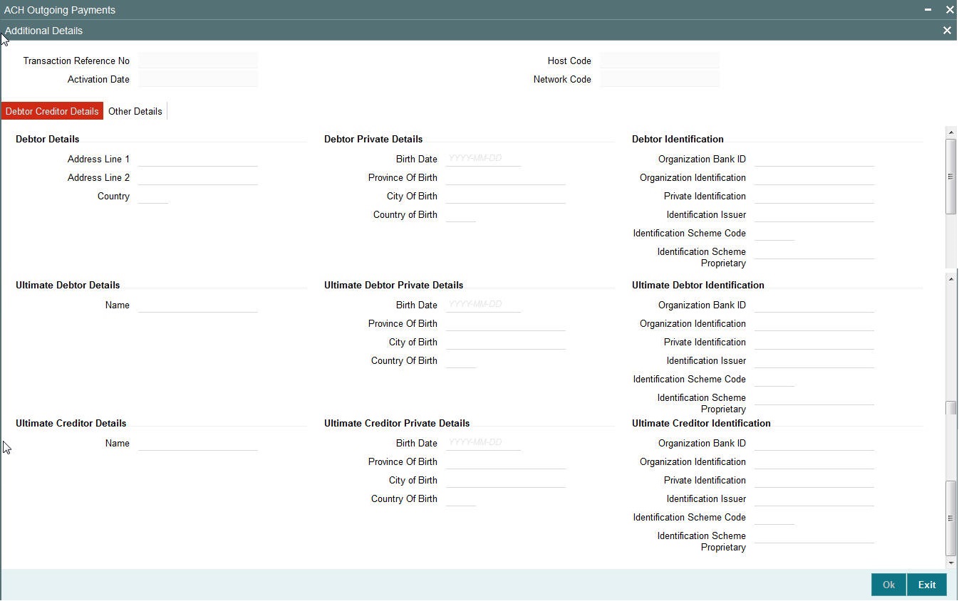

Specify the additional details in this screen. Click on the ‘Additional Details Button’ to invoke this screen.
Specify the debtor and creditor details:
Address Line 1
Specify the address of the debtor.
Address Line 2
Country
Specify the Country of residence of the debtor. Alternatively, you can select the country from the option list. The list displays all valid country codes maintained in the system.
Birth Date
Select the date of birth of debtor from the adjoining calender.
Province Of Birth
Specify the province of birth of the debtor.
City Of Birth
Specify the city of birth of the debtor.
Country Of Birth
Specify the country of birth of the debtor. Alternatively, you can select the country from the option list. The list displays all valid country codes maintained in the system.
Organization Bank ID
Specify the organization bank id of debtor.
Private Identification
Specify the private identification number of debtor.
Identification Issuer
Specify the identification issuer details.
Identification Scheme Code
Specify the identification scheme code.
Identification Scheme Proprietary
Specify the identification scheme proprietary details.
Address Line 1
Specify the address of the creditor.
Address Line 2
Country
Specify the Country of residence of the creditor. Alternatively, you can select the country from the option list. The list displays all valid country codes maintained in the system.
Birth Date
Select the date of birth of creditor from the adjoining calender.
Province Of Birth
Specify the province of birth.
City Of Birth
Specify the city of birth of the creditor.
Country Of Birth
Specify the country of birth of the creditor. Alternatively, you can select the country from the option list. The list displays all valid country codes maintained in the system.
Specify the organization bank id of creditor.
Specify the private identification number of creditor.
Name
Specify the debtor name.
Birth Date
Select the debtor date of birth from the adjoining calender.
Province Of Birth
Specify the debtor province of birth.
City Of Birth
Specify the city of birth of debtor.
Country Of Birth
Specify the country of birth of the debtor. Alternatively you can select the country of birth from the option list. The list displays all valid country codes maintained in the system.
Specify the organization bank id.
Specify the private identification number.
Specify the identification scheme proprietary.
Name
specify the creditor name.
Birth Date
Province Of Birth
Specify the creditor province of birth.
City Of Birth
Specify the city of birth of creditor.
Country Of Birth
Specify the country of birth of the creditor. Alternatively you can select the country of birth from the option list. The list displays all valid country codes maintained in the system.

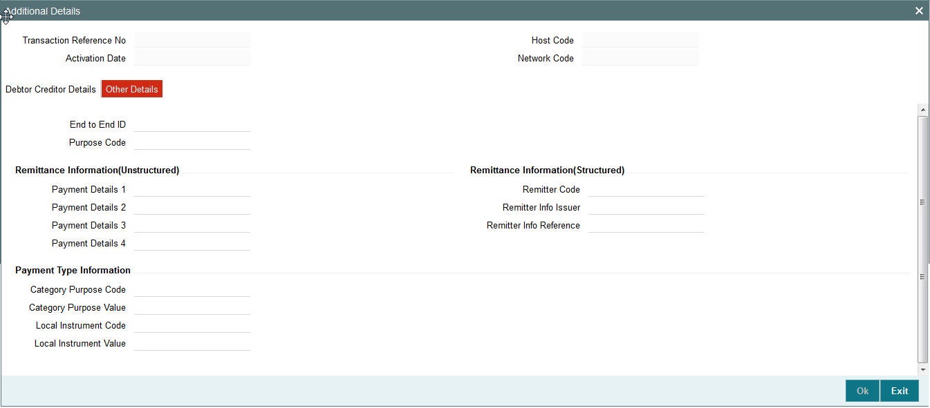

Note
You can capture the below details in this screen.
Category Purpose Code
Specify the category purpose code.
Category Purpose Value
Specify the category purpose value.
Purpose Code
Specify the purpose code.
Local Instrument Code
Specify the local instrument code.
Local Instrument Value
Specify the instrument value.
Note
Remitter Reference
Specify the remitter reference number.
Remitter Code
Specify the remitter code.
Remitter Information Issuer
Specify the remitter information.
Additional Remittance Info
Specify the additional remitter information any.
Payment Details
Specify the payment details.
Note
Only one of structured Payment Details or Unstructured Payment details may be present
Payment Details

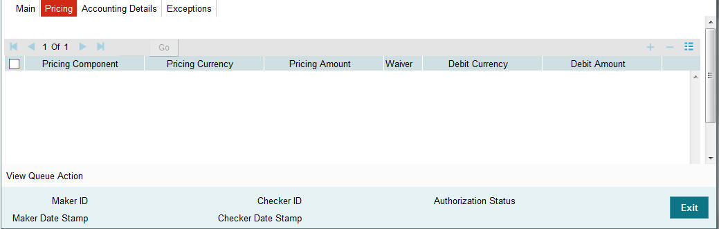

You can view pricing details in this screen. Click on the ‘Pricing’ tab to invoke this screen.

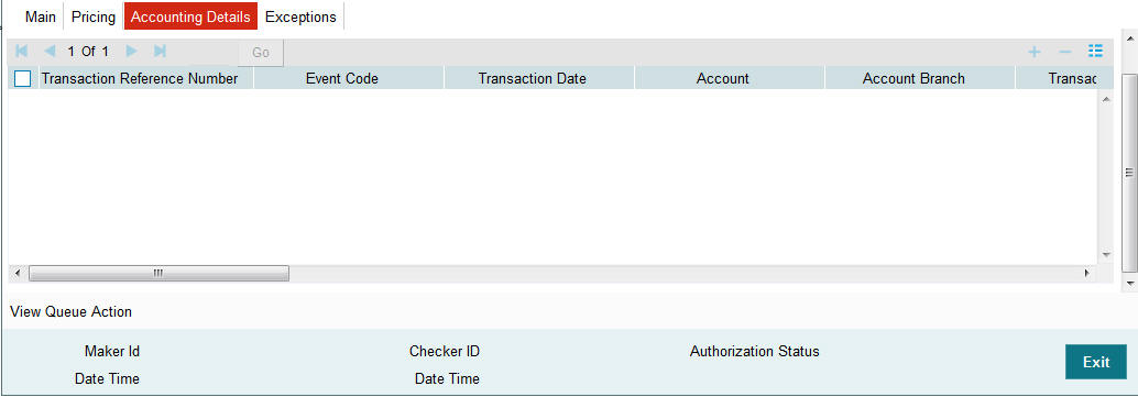

Click on the ‘Accounting Details’ tab to invoke this screen.
You can view the consolidated accounting entries of the transaction.

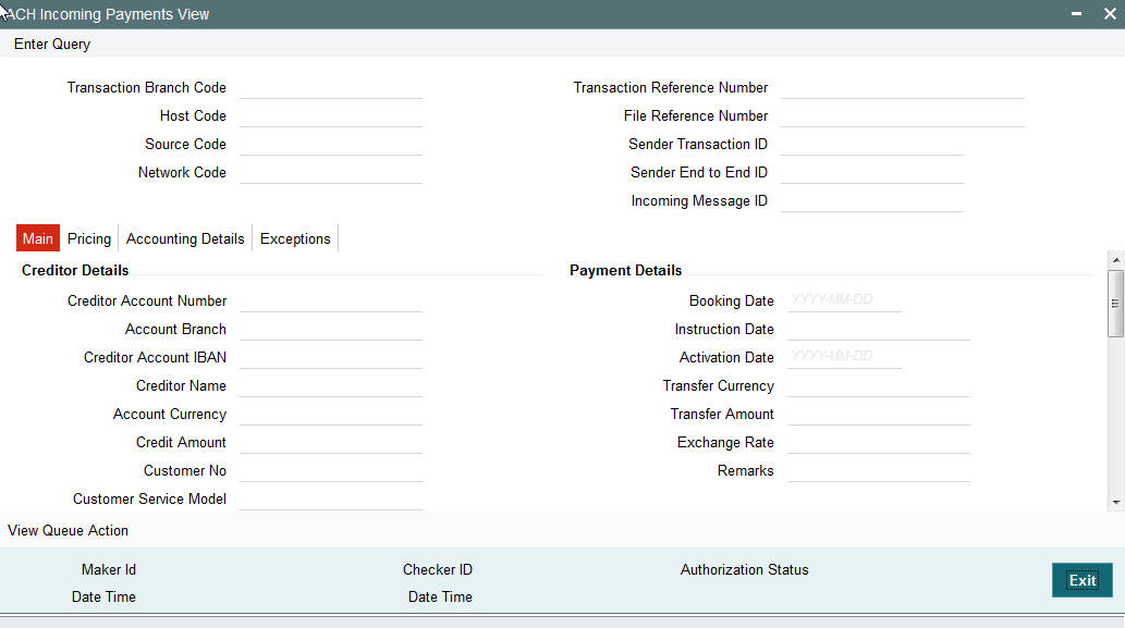

You can view the ACH Incoming transaction in this screen.
You can invoke “ACH Incoming Payments” screen by typing ‘PADIVIEW’ in the field at the top right corner of the Application tool bar and clicking on the adjoining arrow button. Click new button on the Application toolbar..
You can specify the following fields:
Transaction Reference Number
Specify the transaction reference number. Alternatively, you can select the transaction reference number from the option list. The list displays all valid transaction reference numbers maintained in the system.
You can view debtor/Creditor details in this screen. Click on the ‘Main’ tab to invoke this screen.

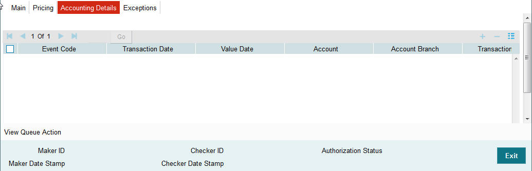

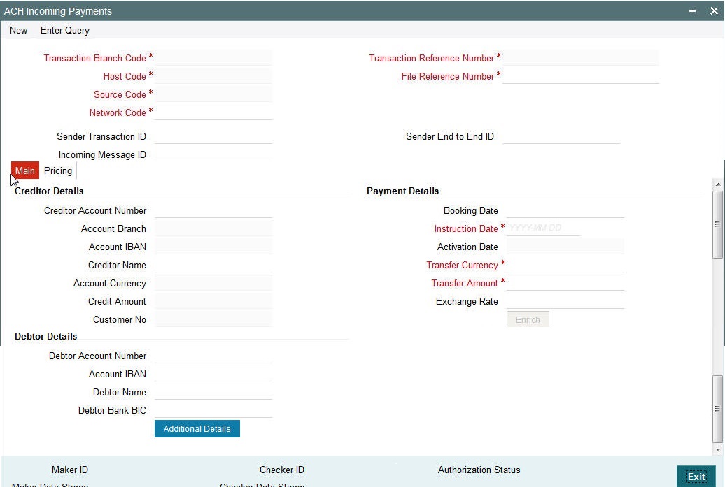

It is now possible to manually create an ACH Incoming Payment by providing the details in the Input screen.
You can invoke the “ACH Incoming Payments Input” screen by typing ‘PADITONL‘ in the field at the top right corner of the application tool bar and clicking on the adjoining arrow button.

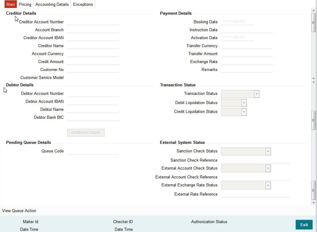

You can view Debtor/Creditor/Payment details in this screen. Click on the ‘Main’ tab to invoke this screen.
Transaction Branch Code
This field is populated as user’s logged in branch
Host Code
This field is defaulted as logged in Host.
Network Code
If only one Network is maintained for with payment type as ACH for the host code, the same will be defaulted in this field.
In case multiple networks are found for the same combination, all applicable networks will be listed for the field.
Source Code
For manually input transactions, source code is defaulted as MANL.
Creditor Account Number
All open and authorized accounts maintained in External Account maintenance are listed. You can select the creditor account. The list of values search page displays the Account IBAN along with Customer No & Customer Name.
Creditor Details
Creditor Account IBAN
Based on the creditor account number, IBAN appears by default in the IBAN field, if it is available.
Account Currency & Creditor Name
These fields are populated based on creditor account chosen.
Credit Amount
This field as populated as the transfer amount converted in credit account currency. The Exchange rate pick up is based on network preferences.
Debtor Details
Debtor Account Number & Account IBAN
Either debtor account number or account IBAN is mandatory. If the network is ‘IBAN Check’ enabled, it will be mandatory to specify debtor account IBAN
Debtor Name
Specify Debtor Name.
Debtor Bank Code
All open and authorized Bank Codes/BIC codes available in local bank directory are listed in this field. The listing is based on the ‘Bank Network Identifier’ maintained for Network maintenance (PMDNWMNT).
You can choose the appropriate bank code. This is a mandatory field.
Booking Date & Value date
Both booking date & Instruction date are defaulted as current date. Instruction date can be modified as a back date or forward date.
Transfer Currency
If the network allows only single currency as per Network currency preferences screen (PMDNCMNT), this currency will be populated as transfer currency. If multiple currencies are allowed, you can select from the list of allowed currencies.
Transfer Amount
Specifies the amount received in the incoming payment. This is a mandatory field.
Exchange Rate
If transfer currency & creditor account currency are different, then exchange rate can be provided by the user. The system retain the input value and validates the same against override and stop variances maintained in Network Preferences screen.
If exchange rate is not a user input, the system picks up the exchange rate during ‘Enrich’ provided the transfer amount is less than the small FX limit maintained. If the exchange rate is not available, system displays an error message.
If transfer amount is more than the small FX limit and if external exchange rate is applicable, then exchange rate pick up will happen during transaction processing.

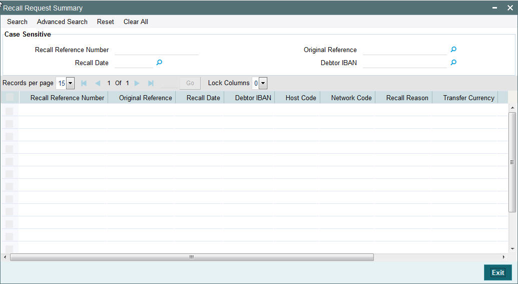

You can invoke the ‘Recall Request Summary’ screen by typing ‘PASOTRCL’ in the field at the top right corner of the application toolbar and clicking the adjoining arrow button.Click new button on the Application toolbar.
You can click ‘Search’ button to view all the pending functions. However, you can to filter your search based on any of the following criteria:
When you click ‘Search’ button the records matching the specified search criteria are displayed.

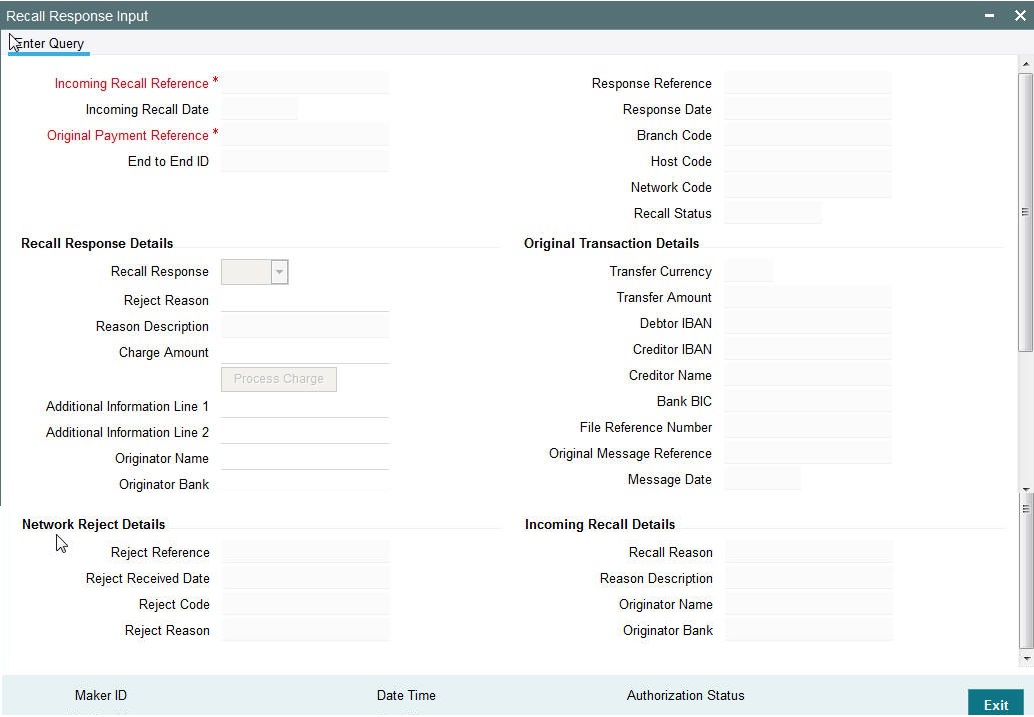

You can access the Recall Response Input Screen by typing PADITRCL in the field in the top right corner of the application tool bar and clicking on the adjoining arrow button.
Recall requests received by the Beneficiary Bank are available in this screen.You can query the records and provide positive/negative response to the Originating Bank.
You can query the available records by providing the Incoming Recall reference number.
The following details is defaulted:
You can unlock the record and provide the recall response details:
Recall Response
You can either accept or reject the recall request received.
Reject Reason
The applicable reject code for the action can be selected
Reason Description
Reason description is populated based on the Reject reason chosen.
Charge Amount
If the recall request is accepted you can mention the charge amount applicable. This amount is reduced from the payment amount while returning the funds.
On clicking Process Charge button, the system defined charge is defaulted. The charge is populated based on the Recall Acceptance Price code maintenance for the transaction type ‘Incoming’ in Network Currency Preferences. You can override the defaulted charge.
