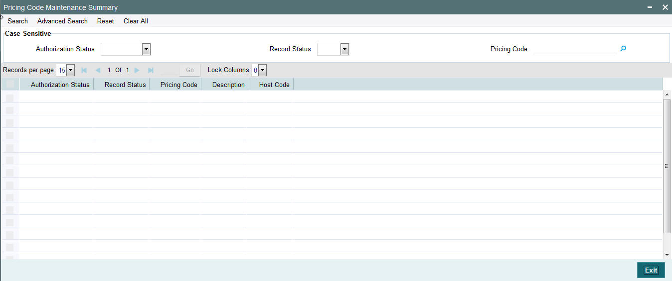

You can view the summary in “Pricing Code Summary” screen.
You can invoke the ‘Pricing Code Summary’ screen by typing ’ PPSCDMNT’ in the field at the top right corner of the Application toolbar and clicking on the adjoining arrow button.
You can search for the records using one or more of the following parameters:
Once you have specified the search parameters, click ‘Execute Query’ button. The system displays the records that match the search criteria.
Double click a record or click the ‘Details’ button after selecting a record to view the detailed screen.

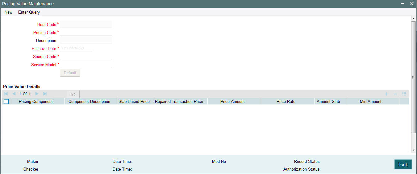

You can maintain effective date wise, Charge/tax amount or rate applicable for components linked to a charge code in the ‘Pricing Value Maintenance’ screen.
You can invoke ‘Pricing Value Maintenance’ screen by typing ‘PPDVLMNT’ in the field at the top right corner of the Application toolbar and clicking on the adjoining arrow button.
You can specify the following fields:
Pricing Code
Specify the pricing code. Alternatively, you can select the pricing code from the option list. The list displays all valid pricing codes maintained in the system.
Description
The system displays the pricing code description.
Effective Date
Effective date is defaulted as system date which can be modified to a future date if required.Back dated changes are not be allowed.
Source Code
Specify the source code. Alternatively, you can select the source code from the option list. The list displays all valid source codes maintained in the system.
Customer Service Model
Specify the customer service model. Alternatively, you can select the Service Model from the option list. The list displays all valid customer service models maintained in the system.
On pressing the Default button all pricing components linked to the pricing code are displayed.
Pricing Rate
Specify the pricing rate.
Note
Pricing Amount
Specify the pricing amount.
Slab Based Price
If this flag is checked price details will be maintained amount slab-wise.
Repaired Transaction Price
Check this box to indicate that the price value is dependent if the transaction is a repaired transaction.
Amount Slab Details
Click this button to specify amount slabs. Tier based calculation is not supported.
In the slab wise maintenance, provision is given to maintain price for normal/repaired transactions separately.
Price Unit
Price unit is used to update the basis amount as the multiple of unit specified (always round up of amount will be done).
Min Amount
Specify the minimum amount that is allowed for rate type charge or tax.
Max Amount
Specify the maximum amount that is allowed for rate type charge or tax.
Borne by Bank
Check this box to indicate if any price component is be paid by the bank.
Waiver Flag
If waiver flag is checked for a component, computed price amount will not get applied in customer account.
If any charge component is marked as waived, related tax components will get automatically waived.

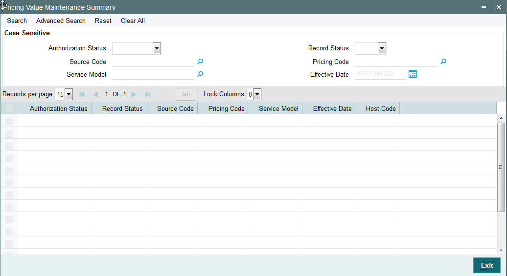

You can view the summary in ‘Pricing Value Summary’ screen. You can invoke the ‘Pricing Value Summary’ screen by typing ‘PPSVLMNT’ in the field at the top right corner of the Application toolbar and clicking on the adjoining arrow button.

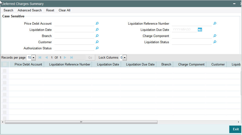

The Deferred Charges Liquidation Summary screen is used to view the list of all consolidated deferred charges for a charge component and an account.
Liquidation references is created by system upfront for a combination of Charge Account, Transaction Branch, Price Code & Component. This screen lists all the liquidation references both pending and liquidated.
You can view the summary in ‘Deferred Price Liquidation Summary’ screen. You can invoke the ‘Deferred Price Liquidation Summary’ screen by typing ‘PPSDEFLQ’ in the field at the top right corner of the Application toolbar and clicking on the adjoining arrow button.
Once you have specified the search parameters, click ‘Search’ button. The system displays the records that match the search criteria.
On double click of a record, “Deferred Charge Liquidation Detailed” screen is launched with the details of the entry in the Header block with the detailed fields. Detailed block displays all the corresponding transaction wise individual entries with the charge amount and charge currency details.
You are allowed to initiate liquidation of a record for which liquidation status is pending.

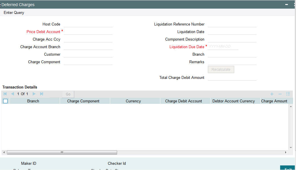

You can liquidate the deferred charges on an ad-hoc basis for a charge account in the ‘Deferred Charges Liquidation Detailed’ screen.
The following Operations will be supported from the Detailed Screen:
You can invoke the ‘Deferred Charges Liquidation Detailed’ screen by typing ‘PPDDEFLQ’ in the field at the top right corner of the application toolbar and clicking the adjoining arrow button.
You can query a deferred liquidation record by providing liquidation reference number.The following details are populated:
Host Code
Host code of the logged in branch is displayed.
Liquidation Reference
Specify the Liquidation Reference for the deferred charges and query for the selected record details.
Liquidation Date
The system displays the date for the charge period based on the frequency setup maintained at the charge component level.
Price Debit Account
The system displays the debit account. Alternatively, you can select the debit account from the option list. The list displays all valid debit accounts maintained in the system.
Account Currency
The system displays the account currency.
Component Description
The system displays the description of the charge component.
Account Branch
The system displays the required branch in which liquidation of the deferred charges are done.
Liquidation Due Date
Customer
The system displays the details of the customer.
Transaction Branch
Charge Component
The system displays the charge component.
Component Currency
The system displays the required currency.
Remarks
The system displays any valid remarks.
The system displays any description of the charge component.
Total Debit Amount
The system recalculates the total debit amount upon clicking the Recalculate button.
Notification will be generated once liquidation accounting is done.
Notification format will be as below:
| Notification Code | Details | Text | |||
| PM_DEF_CHG_1 -Debit Notification for deferred charges | Price Account | Account <Price Account>is debited for <Account Currency >,<Total Amount> on < Liquidation Date> with Reference Number< Reference Number>. being consolidated amount for <Component Description> | |||
| Account Currency | |||||
| Account Branch | |||||
| Liquidation Date | |||||
| Liquidation Reference | |||||
| Charge/Tax debit amount | |||||
