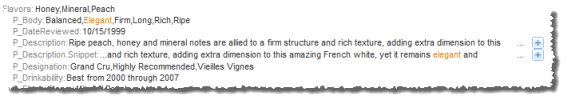

For regular keyword searches, on the Data Explorer, Results List, and Results Table components, the search terms may be highlighted. For attributes that support snippeting, the search snippet is displayed. The snippet displays the portion of the attribute value that contains the search terms.
Search snippet on the Data Explorer component
