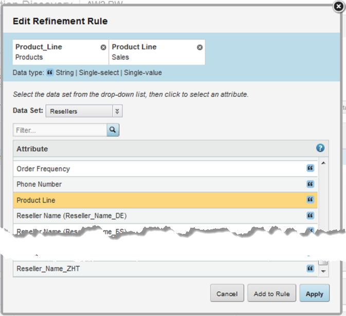

      When you click the + button, the Edit Refinement Rule dialog displays. At the top of the dialog are the currently selected data sets and attributes.

    3. In the Attribute list, to add the attribute to the refinement rule, double-click the attribute.
      Edit Refinement Rule dialog with an attribute selected
      You can also click the attribute, then click Add to Rule.
