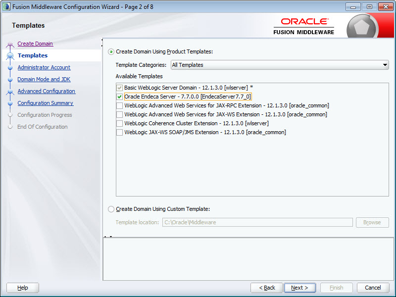

  4. At the Templates screen, select Oracle Endeca Server - 7.7.0.0 and click Next.

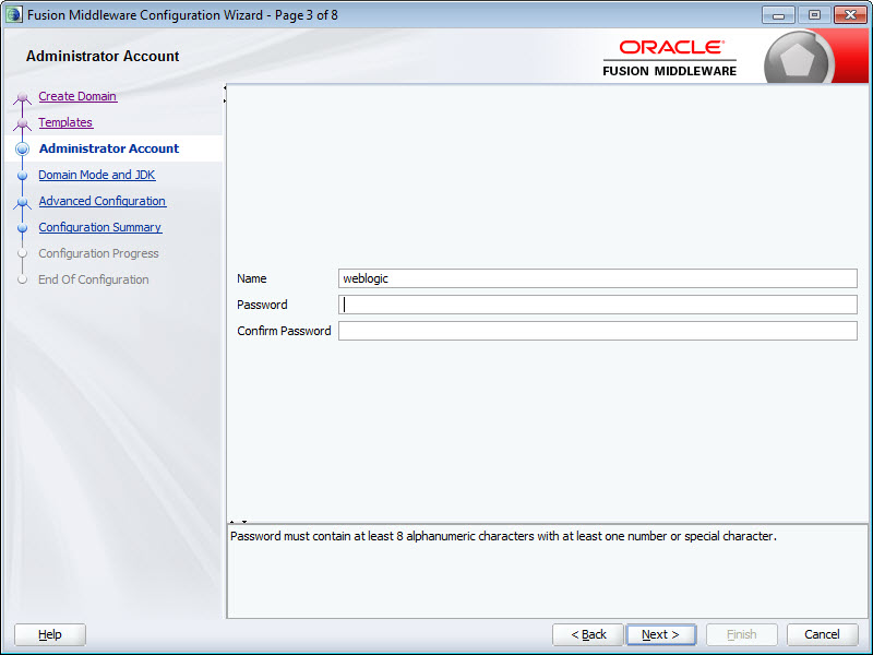

  5. At the Administrator Account screen, enter a name and password for the domain administrator, then click Next.
    The password must contain at least eight characters, including one special character or number.

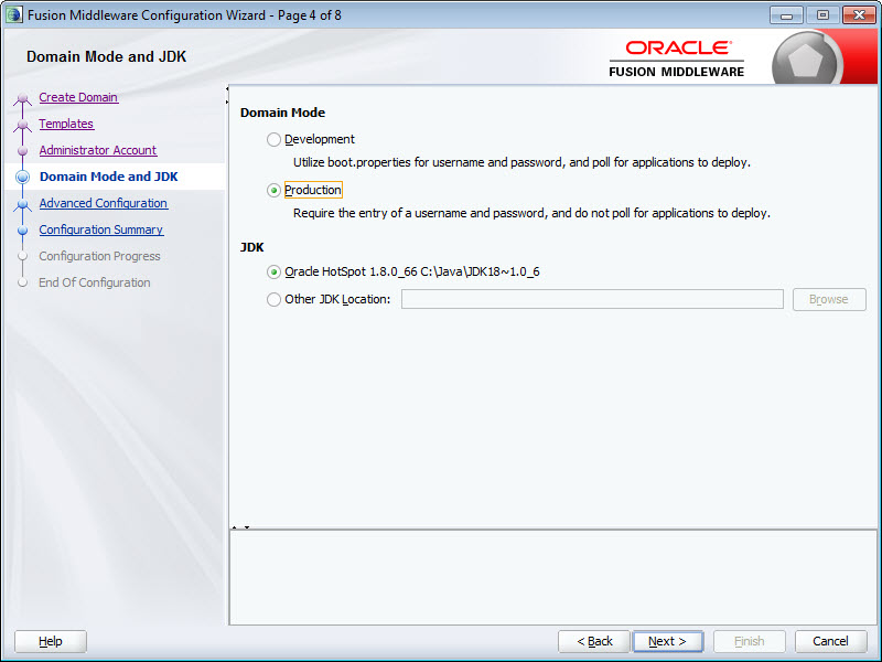

  6. At the Domain Mode and JDK screen, select Production and make sure the correct JDK is selected.
    If the default JDK is incorrect, select Other JDK Location and browse to the correct one.
    Click Next when you're done.

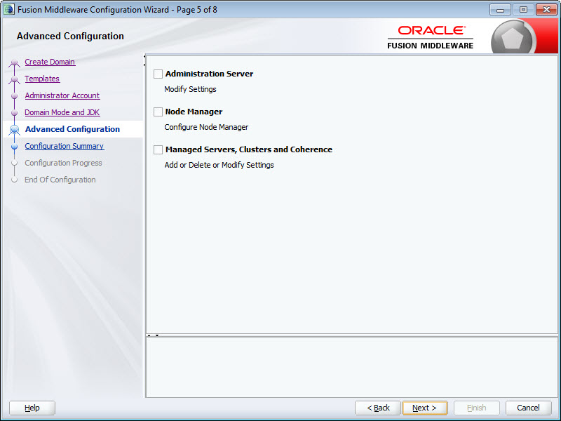

  7. At the Advanced Configuration screen, click Next without selecting any options.
    (Note that accepting the default configuration means that WebLogic Server will run on port 7001.)

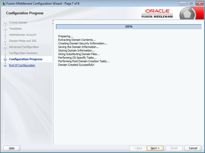

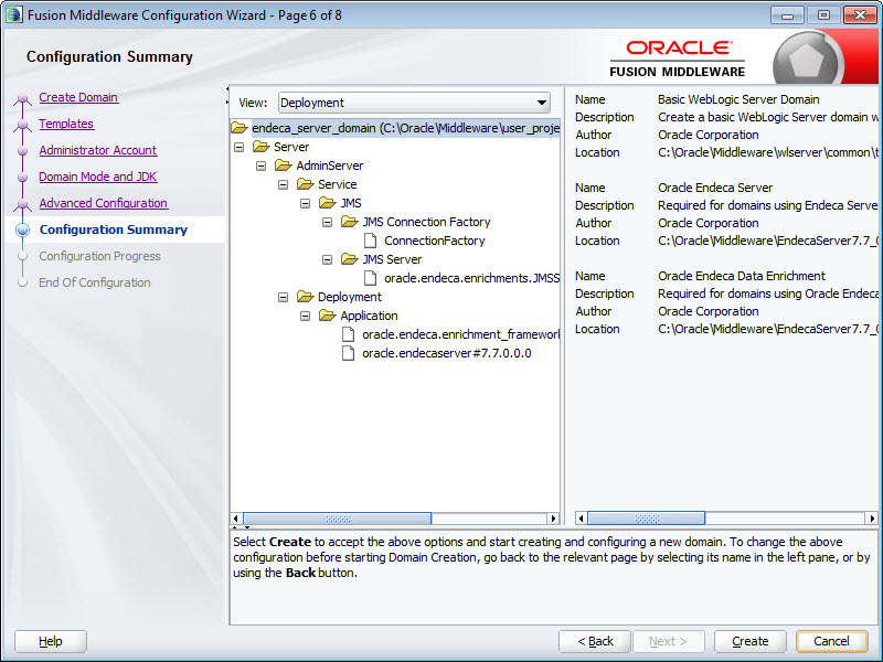

  8. At the Configuration Summary screen, click Create to create the domain.
  9. At theConfiguration Progress screen, wait for the domain to be created, then click Next.

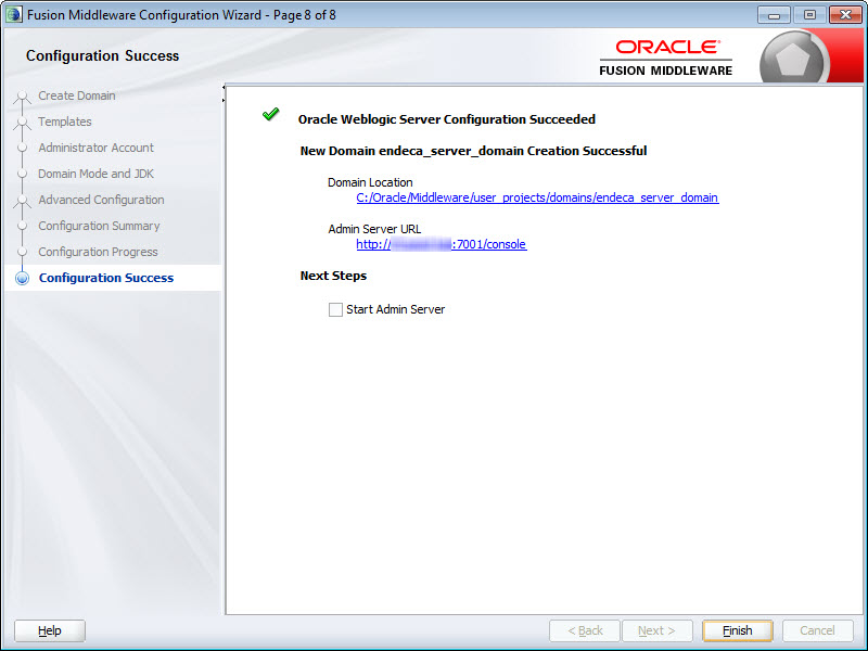

  10. At the Configuration Success screen, review the domain information and click Finish.
As a result, the WebLogic domain is created with a WebLogic Server port of 7001.
