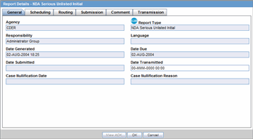

| View Report | Displays the details of the selected report. |
| Report Details | Displays specific information about the report as entered in the Regulatory Reports section.
Note: The information displayed in the fields of the Report Details dialog is fetched from the data entered in the Regulatory Reports section of Case Form. Refer to the About the Report Details Dialog Box section for descriptions of each tab. |

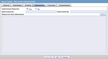

| Mark for Non-Submission | Displays the Submission tab in the Report Details dialog.
Select No for Mark for Non-Submission and enter the reason for the non-submission. |

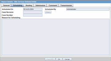

Use the following procedure to schedule reports.
Open the case for which the report has to be scheduled.
When the system displays the Case Form for the selected case, select Regulatory Reports --> Schedule New Reports.
When the system opens the Schedule New Expedited Report dialog box, enter the appropriate information in the fields in the dialog box.
Click OK to schedule the report.
Save the case to save the report.

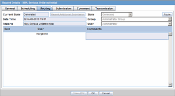

Use the following procedure to approve reports.
Open the case associated with the report that needs to be approved.
When the system opens the Case Form, click the Regulatory Reports tab to displays the case details.
Click the icon associated with the report you wish to approve and select View Report Details.
When the system opens the Report Details dialog, click the Routing tab.
When the system opens the Routing tab, select Approved from the State drop-down list and click Route.
When the system opens a dialog box, enter the required information and click OK to approve the report.
Note: Refer to Report Routing to understand how you can route a report to another state. |

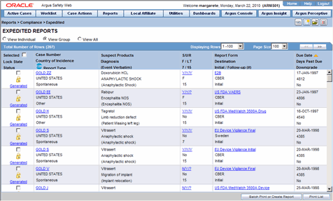

Use the following procedure to create unscheduled expedited reports.
Select Reports --> Expedited --> Compliance.
Expedited Reports Dialog Box Fields and Fields Descriptions
| Field | Description |
| Selected | Click the checkbox to select the report. |
| Lock State | Displays if the case is locked or un-locked. |
| Status | Displays the Report Status e.g. Scheduled or Generated etc.
Note: Click the link displaying the status to view the report details. |
| Case Number | Displays the Case Number.
Note: Click the link displaying the Case Number to open the selected case. |
| Country of Incidence | Displays the Country of Incidence for the selected case. |
| Report Type | Displays the Report Type of the selected case. |
| Suspect Product | Displays the Trade Name for which the report has been scheduled. A (+) displayed at the end of the Product Name denotes that more than one Suspect Company Product exists.
For Reports which were scheduled for the Device, the Device name gets displayed. |
| Diagnosis | Displays the Primary Event Diagnoses PT |
| Event Verbatim | Displays the (verbatim as reported) of the Primary Event. |
| S/U/R | Displays the Case Level Assessments
Click the SUR link to view the Case Summary. |
| F / LT | Denotes Fatal / Life Threatening
If the case is both F and LT, only F is displayed. If the case is neither F nor LT, No is displayed. |

Select Expedited Reports from the Reports - Compliance menu.
When the system opens the Expedited Reports dialog box, click Batch Print or Create Report.
Expedited Reports Dialog Box Fields and Field Description
The following table lists and describes the fields in the Expedited Reports dialog box.
| Selected | Click the check box to select the report. |
| 7/15 | Displays 7 if the report is due within 7 days
Displays 15 if the report is due in more than 7 days |
| Report Form | Displays the Description of the report
Click the link to view the DRAFT Report PDF. |
| Destination | Displays the Report Destination (Agency) for which the report is scheduled. |
| Initial / Follow-up (#) | Displays the status whether it is Initial or Follow-up
If it is Follow-up, the follow-up number is also displayed. |
| Due Date | Displays the due date. |
| Days Past Due | Displays the number of days the report is past due date. |
| Downgrade | Displays Yes if the report is a Downgrade Report. |
| View All | Allows the administrator and workflow manager to see all items in the system. |
| View Group | Allows the user to view all items assigned to this user group. |
| Individual | Allows the user to view all items assigned to him. |
| Print List Button | Allows the user to print the current Expedited Reports List for referencing the current view of the Expedited Reports List. |

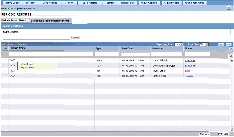

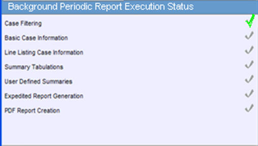

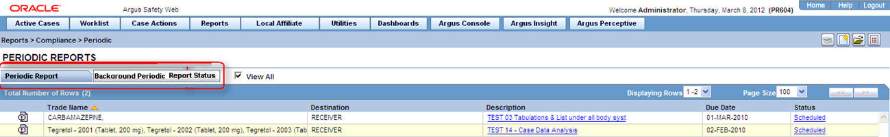

This section discusses the different fields and features available in Periodic Reports.
The Periodic Reports screen comprises two tabs: Periodic Report tab, and Background Periodic Report Status tab.
When using periodic reports, be aware of the following:

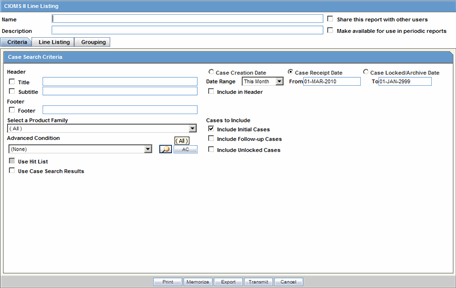

You can filter cases in the following period reports based on the Case Locked/Archived date:
NDA
IND
PSUR
CTPR
When you select the Case Locked/Archived date, the system limits the cases based on whether the case has been locked or archived within the specified time frame.
The locked date is the lock date for the current case.
If there is significant FU in the reporting time frame, the system considers the case a follow-up case in the group options of the PSUR/CTPR reports.
If you specify the time frame for the case locked/archived date, the system disables the following:
Include Follow-up
Exclude Follow-up
Include Summary of Unlocked Cases
Include Unlocked Cases
For the 15 day report section of the NDA Reports, the system uses the timestamp to determine whether there are further follow-up or downgraded cases in that date range.
The following table lists and describes the data that appear in the columns on the Periodic Reports screen:
| View All | Enables the user to view all available periodic reports. |
| Trade Name | Displays the Trade Name. |
| Destination | Displays the name of the Destination. |
| Description | Displays the report name. Click this to open the selected report in PDF format. |
| Due Date | Displays the Due Date. |
| Status | Opens the Report Details dialog for the selected report. |
| Print List | Allows the user to print the current Periodic Reporting for referencing the current view of the Periodic Reporting. |
Common features on the Period Reports page. Click the icon associated with each report to view the following options:

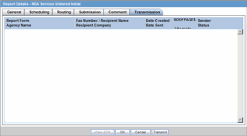

The Report Details dialog box includes several tabs.
General Tab
The General tab displays the general information about the report. The information on this tab cannot be modified.
The following table lists and describes the fields on the General tab.
| Agency | Displays the Reporting Destination for which the report is scheduled. |
| Responsibility | Displays the User Group to which the report is assigned. |
| Date Generated | Displays the date when the report was generated. |
| Date Submitted | Displays the date when the report was submitted. |
| Report Type | Displays the Expedited Report Form of the report. |
| Language | Displays the language in which the report has been made. |
| Date Due | Displays the date when the report is due. |
| Date Transmitted | Displays the date when the report was transmitted. |
| Case Nullification Date | Displays the date when the case was nullified. |
| Case Nullification Reason | Displays the reason entered when a case is logically deleted in Argus. |
The Scheduling tab displays a reason for scheduling this report. It also shows the date on which the report was scheduled.
The following table lists and describes the fields on the Scheduling tab.
| Scheduled On | Displays the date when the report was scheduled. |
| Scheduled By | Displays the name of the person who schedule the report. |
| Case Revision | Displays the case revision number. |
| Case Number | Displays the case number. |
| Reason for Scheduling | Displays the reason for scheduling the report. |
Note: All fields in this tab are auto-populated as per records entered in Argus. |
The Routing tab displays the routing history of the report. To route the report, click Route.
The following table lists and describes the fields on the Routing tab.
| Current State | Displays the current state of the report. |
| State | Displays the state of the report. This button is enabled when you click the Route button. |
| Date Time | Displays the date and time of the report routing. |
| Group | Displays the group of the report. This button is enabled when you click the Route button. |
| Reports | Displays the type of report it is. |
| User | Displays the state of the report. This button is enabled when you click the Route button. |
| Comments | Displays routing comments entered before routing the report. |
The Submission tab enables you to specify whether submission is required and enter a reason for not submitting the report.
The following table lists and describes the fields on the Submission tab.
| Submission Required | Enables you to select if this report is not required to be submitted to the regulatory authority. |
| Determined On | Displays the date when the report was considered not required to be submitted. |
| Determined By | Displays the name of the user who decided the report was not required to be submitted. |
| Reason for Non-Submission | Click Select to select the reason for non-submission. |

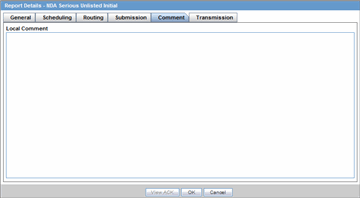

The Comment tab enables you to enter a local comment that prints out on that specific report when generated. Each report has its own Local Comment section.
The following describes the Local Comment field on the Report Details tab.
| Local Comment | Enables you to enter any remarks about the report. |
Transmission Tab
To transmit a report
Click the icon associated with a report and select the Transmission tab from Report Details.
When the system opens the Report Details The Report Details dialog opens.
This dialog displays the status of reports that have been transmitted to different recipients.
The following table lists the fields that comprise the Report Details dialog.
| Report Form | Displays the name and type of report being transmitted. |
| Agency Name | Displays the agency name for the report. |
| Fax Number / Recipient Name | Displays the Fax Number or name of the recipient of the report. |
| Recipient Company | Displays the name of the company that is receiving the report. |
| Date Created | Displays the date when the report was created. |
| Date Sent | Displays the date when the report was sent. |
| # of Pages | Displays the number of pages present in the report. |
| Attempts | Displays the number of attempts in transmitting the report. |
| Sender | Displays the sender of the report. |
| Status | Displays the transmission status of the report. |
Click OK or Cancel to approve the transmission or discard any changes, respectively.
Click the Transmit button to transmit a report. The Transmit to Recipients dialog is displayed.
Select the recipients of the report, as applicable from the Available Recipients list.
Select the method of transmission from Method, as applicable.
Enter remarks in Comments.
Click Transmit.
The selected report is transmitted to the specified recipients.
The Background Periodic Report Status tab is displayed for users who have been configured by the Argus Safety administrator in Argus Console, under Access Management > Groups > Menu > Reports > Periodic Reports.
The following table displays a description of the Background Periodic Report Status tab:
| Report Name | Displays the name of the report, as entered in the Report Configuration screen. |
| Report Type | Displays the type of the report, such as NDA, PSUR, CTPR, etc. |
| Start Date | Displays the date and time when the report generation started.
For English users, it is displayed in DD-MMM-YYYY HH:MM:SS (GMT offset) format. For Japanese users, it is displayed in YYYY/MM/DD 00:00 (GMT offset) format. |
| Username | Displays the username of the user who initiated the report. |
| Status | Displays the current status of report generation in the form of hyperlinks, with the options listed below:
Executing Error Pending Generated On clicking the Generated status, the Periodic Report is displayed. On selecting any status other than Generated, the Background Periodic Report Execution Status dialog is displayed, as shown below:
This dialog displays the different stages of Periodic Report status. A grey tick mark is denotes Pending state, a Green tick mark denotes Completed State, and a Red cross mark denotes an Error. |
| Refresh | Allows you to refresh the screen. |
| Print List | Allows you to print the entries in Background Periodic Report Status for reference of the current view. |
| Context Menu > View Report | This option is displayed in the context menu only when 'PDF/CSV/RTF Report Creation' is 'Generated'. On clicking View Report, the selected report is displayed. |
| Remove Report | Allows you to remove a selected report. Reports can be selected from the AG Service Report Status screen and can be removed by clicking this Remove Report context menu option. On selecting this option, a Justification for the removal must be provided, after which the report is removed. |

Before you can mark a report as submitted, the report must first be approved.
Use the following procedure the submit an approved report.
Open the case for which the report has to be approved.
Open the Regulatory Reports tab in the Case Form.
When the system opens the Regulatory Reports details for the selected case, click the icon associated with the report you wish to approve.
Select View Report Details.
Note: The Case Nullification Date is the date when the case is deleted, the Case Nullification Reason is the comment entered when the case is logically deleted in Argus. |
Select Submitted from the State list in the Routing tab and click Route.
When the system opens a dialog box, enter the required details and click OK.
The report is approved.
Note: A user who has "Workflow Manager" rights can undo the submission of a report, if necessary. |

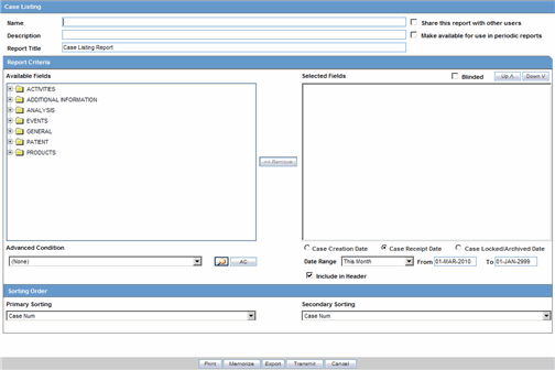

Case Listing Report

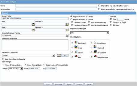

You can filter cases in the following aggregate reports based on the lock/archived date:
Case Listing
Case Data Analysis
CIOMS II Line Listing
When you select Case Locked/Archived date, the system limits the cases based on whether the case is locked/archived within the specified time frame.
The lock date is considered the locked date.
If you select the Case Patient or Reporter Information in the Case Listing or CIOMS II Line Listing reports and the Protect Confidentiality field is checked for the patient or reporter Information, the system does not print the relevant patient or reporter Information selected in the Case Listing or CIOMS II Line Listing report.
If you do not have permission to view the reporter or patient information, the corresponding reporter or patient elements selected on the Case Listing or CIOMS II Line Listing report are blank.
If the report doesn't have cases that meet the criteria, the system prints the PDF with a "No data found" message.

The Case Data Analysis Report enables you to view quantities of cases over time in a Cross-Tabular Fashion. Use the following procedure to create a Case Data Analysis report. The following is an illustration of a Case Data Analysis Report.
To create a Case Data Analysis Report
Select Reports --> Aggregate Reports --> Case Data Analysis.
In the Case Data Analysis Report view, select the information that must appear in the report.
In Row1, select the field the system uses to group cases by row.
In Column1, select the data the system uses to group cases by column.
In Row2, select the field by which each Row1 item will be categorized.
In Column2, select the field by which each Column1 item will be categorized.
Select a product family to which the report applies, if appropriate.
In Selection for Row1, select the value for row 1 by which the report must be restricted.
Specify an advanced condition, as appropriate.
Select Report Number of Cases or Report Number of Events, depending on the number of cases or the number of events to be entered in the report.
If you select Report Number of Events, you can specify the kind of events (serious listed, non-serious listed, serious non-listed, or non- serious non-listed) that will appear in the report.
Select whether only the top few items should be displayed and enter the number of items that should be displayed.
Select the Show % of Total check box to specify the percentage in each cell in the report.
Select the Blinded check box to hide blinded information in the report.
Select the Use Case Search Results checkbox to limit the Case Data Analysis only to the cases present in the Case Search dialog.
Specify a date range for the cases that will appear in the report.
1In Report Type, select whether the report is to be printed in text (data) format or in graphical (chart) format.
If you select Chart, you can specify the kind of chart (bar graph, line chart, etc.) that will be used to display the information.
Enter a title for the report.
To memorize the criteria for a specific report
Click Memorize to open the Memorized Report dialog box.
Click Save.
Use the following procedure to save, delete, or cancel a report, as applicable.
To save, delete or cancel the report, as applicable
Click OK in the Case Data Analysis screen to generate the report in PDF format.
To export a report in CSV format, click Export.
To transmit a report using Argus Safety Service, click Transmit.
To delete a report, click Delete.
The CIOMS II line listing report is a common format desired by Drug Safety professionals for reviewing cases. Create this report from the CIOM II Line Listing dialog box shown in the following illustration.
Use the following procedure to create a CIOMS II Line Listing report.
To create the CIOMS II Line Listing report
Select CIOMS II Line Listing from Reports -->Aggregate Reports --> CIOMS II Line Listing.
On the CIOMS II Line Listing Criteria tab, select information for the header, footer, product family, advanced condition (if any), cases to include, and date.
Select either the Case Creation Date or Case Receipt Date radio button and specify a date range to run the report.
Note: If you perform a search and return a list of cases to the Case Search screen, the Use Case Search Results is visible. Checking this box will disable all selection criteria with the exception of "Include Unlocked Cases". For example, the Advanced Condition and Date Range will be disabled. |
In the Line Listing tab, add or remove the appropriate fields.
In the Grouping tab, add or remove elements, insert a page break and change the sort order (if desired).
Save, Delete or Cancel the report, as applicable.
Click OK in the CIOMS II Line Listing screen to generate the report in PDF format.
Click Export to export a report in CSV format.
Click Transmit, to use Argus Safety Service to transmit a report.
The Case Listing Report enables you to filter cases based on Case Initial Receipt Date and Case Creation Date. You can select multiple entities from the List of available fields using the CTRL+CLICK functionality. The following is an illustration of the Case Listing dialog box.
Creating a Case Listing Report
Execute the steps below to create a Case Listing report:
Select Reports --> Aggregate Reports --> Case Listing.
When the system opens the in the Case Listing Reports view select the information to appear on the report.
Select the fields that are to appear in the report from the Available Fields list.
Click Add. Repeat this process for each field that must appear in the report.
Use Move Up and Move Down to arrange the fields in the Selected Fields list.
Select the Blinded checkbox to hide blinded information in the report.
Specify an Advanced Condition, if appropriate.
Specify a date range for the cases to be displayed in the report.
If you select the Include in Header check box, the selected date range is displayed on the report.
Under Sorting Order, select the fields by which the cases will be sorted. The first field allows you to create a list that is sorted with respect to that particular field. Groups of cases that are identical with respect to the first field can be sorted by specifying the second field.
Note: You cannot sort the cases by fields that do not appear on the report. |
Enter the title of the report.
Click Memorize to memorize the criteria specified for a particular report. The Memorized Report dialog appears.
Click OK in the Case Listing Reports screen to generate the report. The report will be generated in PDF format.
