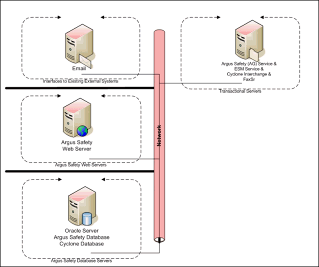

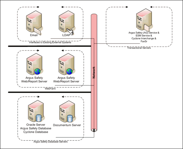

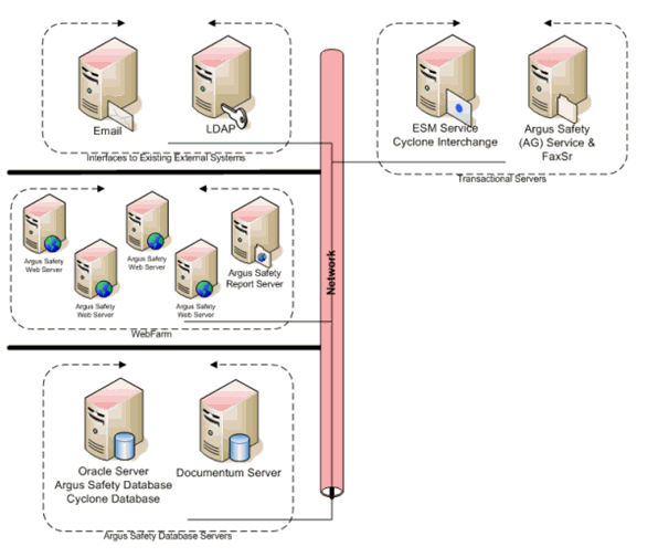

This section provides information about the recommended hardware topology for small, mid-size, and large companies.
The size of your company and licensed Argus components determines the distribution of the software among the servers.
The following are the definitions for small, mid-sized, and large companies.
Small Company: A small company is a company that has from 1 to 50 concurrent users and fewer than 200 new cases reported each month.
Mid-Sized Company: A mid-sized company is a company with 51 to 100 concurrent users and 300 to 600 new cases reported each month.
Large Company: A large company is a company with more than 100 concurrent users and approximately 1000 to 5000 new cases reported each month.
The following image shows the recommended hardware topology for the Argus Safety Hardware for a small company.
