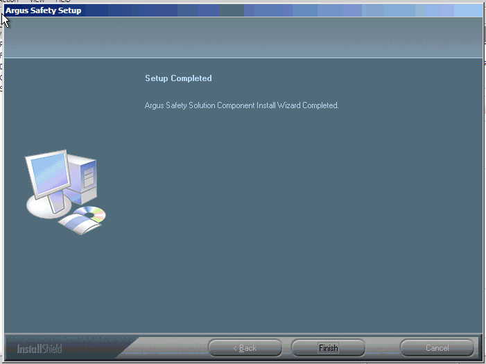

When the system displays the Setup Completed dialog box: Click Finish.

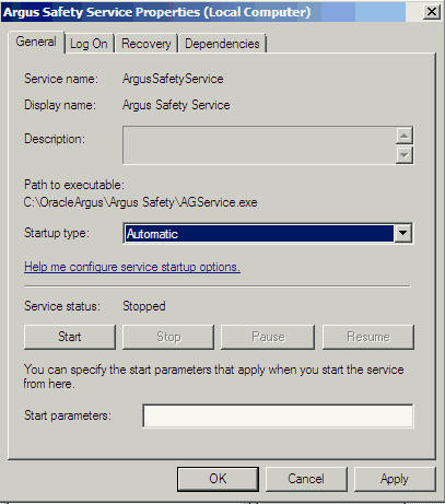

Locate Argus Safety Service in the list of services and select Properties.
The following screen is displayed when the system opens the Argus Safety Service Properties dialog box:
Select Automatic from the Startup type drop-down list.
