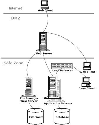

8.4 Small System Configuration
Figure 8-1 Example of a Small System Configuration
Small System Configuation

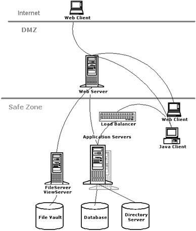

8.5 Medium System Configuration
Figure 8-2 Example of Medium System Configuration
Surrounding text describes Figure 8-2 .

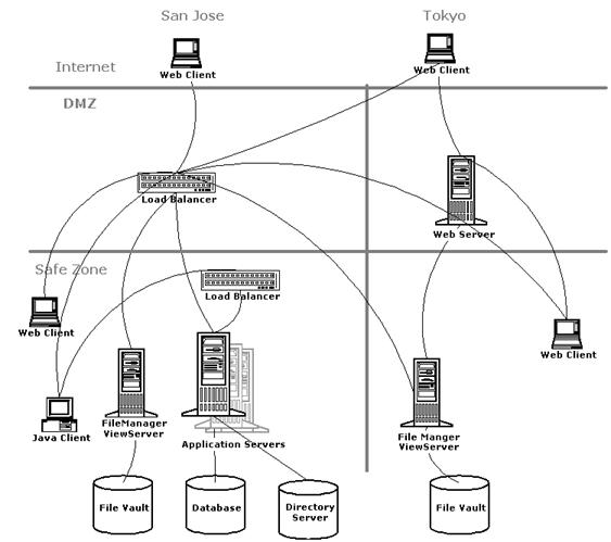

8.7 Extra Large System Configuration
Figure 8-4 Example of Extra Large System Configuration
extra large system configuration
