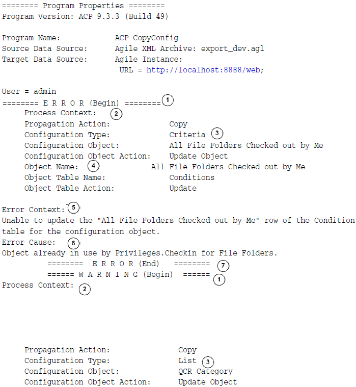

The purpose of the error log is to provide detailed information regarding an error or warning reported by ACP.
Since ACP is not an interactive process, the error information must provide additional information in its error messages.
For instance, ACP provides process context. The process context provides information about what object was being processed when the error occurred. It may even provide more specific information about the object if ACP was currently processing subobject data for the object.
In addition to the process context, it tries to provide error context. The error context provides clues about exactly what ACP was trying to do at the time the error was encountered.
Finally, ACP provides the cause for the error. That is, it reports the error message reported to it. Sometimes the error message will come from the Agile PLM server and other times ACP will report an error itself.

F.5.2 Anatomy of the Error Log
Item # Description
Header Program name, version, and data sources.

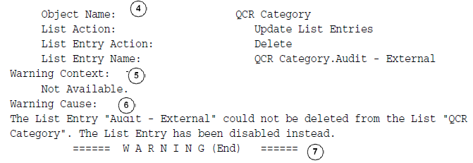

1 Start of Error or Warning Message. Signifies the start of a single error or warning.
2 Process Context. The process context section provides clues about what object ACP was processing at the time of the error or warning
3 Propagation Action, Configuration Type, Configuration Object Context. These three lines of process context provide all of the information you need to know in order to know exactly which object was being processed and action was being performed.
4 Additional Context. Additional context will vary with each error or warning. It attempts to describe within an object what information ACP was working with.
5 Error or Warning Context. The error or warning context provides information about what ACP was doing at the time the error or warning occurred.
6 Error or Warning Cause. The error or warning cause is the specific message issued by the application at the point where the error or warning was detected.
7 End of Error or Warning Message. Signifies the end of a single error or warning.

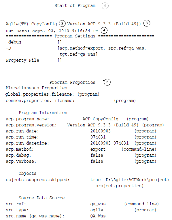

1 Start of Program banner. Signifies the start of a single run of ACP.
2 Name of the ACP module running.
3 Version of ACP running.
4 The date and time that the current run of ACP was started.

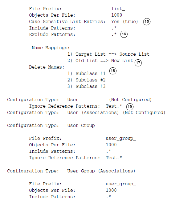

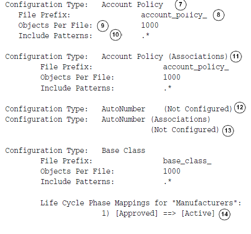

5 Program Properties Section: The properties are a means to influence the business logic that ACP uses with regard to configuration types. The amount of influence on business logic varies by configuration type..

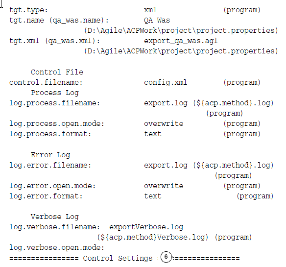

6 Control Setting Section: The configuration values specified in the control file.
7 Configuration Type Name. Each configuration type has its own subsection within the Control Setting Section.

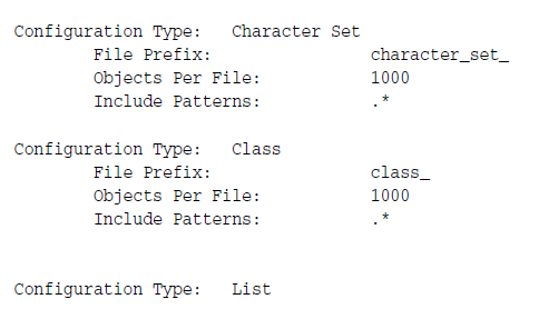

8 File Prefix Setting. This is the file prefix used for the XML files generated by ACP export. The same prefix will be used by ACP import. ACP allows this setting to be configured; however, it should never need to be changed.
9 Objects Per File Setting: This is the number of objects ACP export will write to a single XML file for the configuration type. The default for all configuration types is 1000. Should you have a configuration type that exceeds 1000 and you want to write all of the objects to a single file, you can set the value in the control file.
10 Include Patterns: The list of include patterns configured for the configuration type. These are the regular expressions used to match the object names of the current configuration type.
11 Dependent Configuration Type. Some configuration types have dependent configuration types. The dependent configuration types exist to allow a configuration type to be processed in multiple passes. Typically, dependent configuration types will have the same name as the configuration type they depend on with a suffix such as "(Associations)".
12 Not Configured (Primary Configuration Type). If a configuration type is not configured to be propagated, then it is marked as not configured to make it clear that it is not being propagated.
13 Not Configured (Dependent Configuration Type). Dependent configuration types assume the same configuration information as the configuration type they depend on. If the primary configuration type is not configured, then neither will the dependent configuration type be configured.
14 Sub-object Mappings. Some configuration types allow for sub-object mappings. The sub-object mapping section shows what type of sub-object is being mapped, the name of the object whose sub-objects are being mapped and then the list of mappings.
15 Configuration Type Attributes. Some configuration types may have attributes in addition to the common attributes (file_prefix and objects_per_file). For example, lists have the case_sensitive_list_entries.
16 Exclude Patterns. The list of exclude patterns configured for the configuration type. These are the regular expressions used to match the object names of the current configuration type. If the object name matches an exclude pattern, ACP will skip the object.
17 Name Maps. The list of name mappings for the configuration type that ACP will use to rename objects in the target instance.
18 Delete Names. The list of objects for the configuration type to delete from the target instance.
19 Ignore Reference Patterns. Some configuration types allow ignore reference patterns to be specified. These patterns are used to quash error messages when an object with a name matching one of the patterns cannot be resolved.

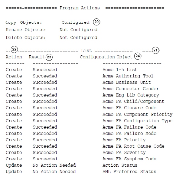

20 Program Actions. The program actions section simply indicates which program actions are configured. The available actions are Copy, Rename, and Delete.

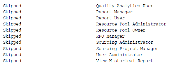

21 Configuration Type Detail. Each configuration type that is propagated has a detailed section showing the action taken for each object of that configuration type. The name of the configuration type is listed at the beginning of the section. Configuration types that have not been configured will not have a detail section. A separate configuration type detail section exists for each program action (Copy, Rename, and Delete) if configured.

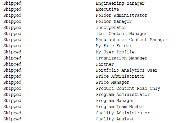

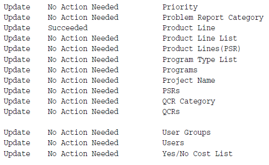

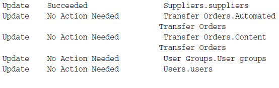

22 Action. The actual action taken by ACP.
Skipped - Was excluded by the include/exclude patterns specified.
Created - The object is new in the target.
Updated - The object already existed in the target.
Renamed - The object's name has changed in the target.
Deleted - The object has been deleted from the target.
23 Result. Indicates how the action performed.
No Action Taken - The target object remains unchanged.
Succeeded - The target object has been changed successfully.
Warning - The target object has been changed successfully, but there were notes to be aware of.
Failed - An error has occurred while processing the object. The object may or may not have been updated.
24 Configuration Object. The name of the configuration object being processed.

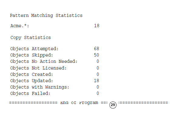

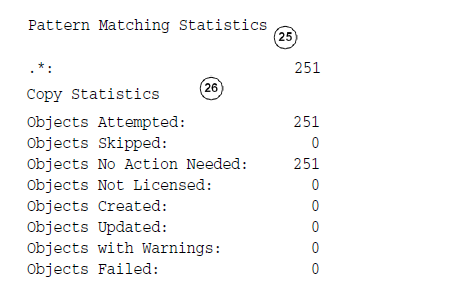

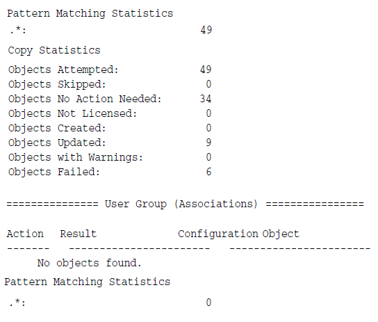

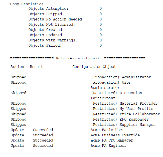

25 Pattern Matching Statistics. The pattern matching statistics help you understand how well your patterns (regular expressions) are matching the objects in the source instance.
26 Copy Statistics (also Rename Statistics and Delete Statistics). The copy statistics section summarizes the object processing for the configuration type. It is an easy way to find out how many objects were propagated as well as the number of objects that are available to propagate.

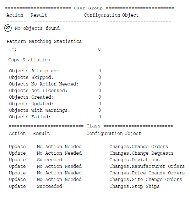

27 No objects found. Indicates that no objects were found for the configuration type. This provides a clear statement to this effect rather than not having anything listed at all.

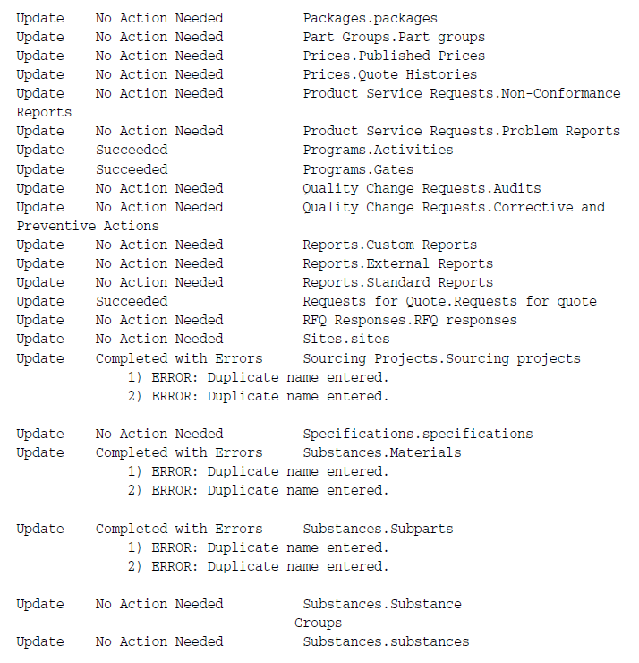

28 Error Messages. A brief description of error messages appear in the Process Log. Please refer to the Error Log for more detailed information about errors.
29 End of Program banner. Signifies the end of a single run of ACP.

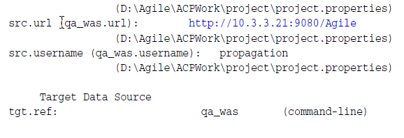

Surrounding text describes sample_process_log1.png.
Surrounding text describes sample_process_log2.png.
Surrounding text describes sample_process_log3.png.
