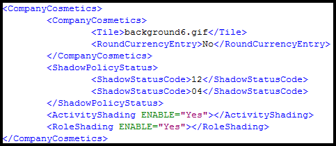

Steps to Configure the CompanyCosmetics Rule
  1. In the Global Rules Explorer, browse to Business RulesSystem and right-click on CompanyCosmetics.
  2. Select NewCompanyCosmeticsOverride.
  3. In the Configuration area, click on the XML Source tab. The XML source is displayed, with only the start and end tags for the CompanyCosmetics rule.
  4. If a background is defined in this rule, add a sub-element <CompanyCosmetics>.
  5. Under the sub-element <CompanyCosmetics> add another sub-element: <Tile>. The name of the file that contains the background for all screens except the login screen should appear between the opening and closing tags of this element.
  6. If shadowing is allowed on the policy, then <ShadowPolicyStatus> should be added as a sub-element to the parent tag, at the same level as the <CompanyCosmetics> sub-heading.
  7. The <ShadowStatusCode> element should appear as a sub-heading to <ShadowPolicyStatus> and should contain all valid status codes that can be assigned to a policy once it is deleted. Status codes are defined in the AsCodeStatus table. These defined statuses will populate the Shadow Status Code drop down box on the Policy Screen Shadow Policy visual editing pane.
  8. If any additional <ShadowStatusCode> elements are needed, then add one for each code.
  9. If Activity Shading is required, add the <ActivityShading ENABLE="Yes"> element after the </CompanyCosmetics> sub-element or the </ShadowPolicyStatus> or the </RoleShading> element. The <ActivityShading> element must not be a sub-element of the <CompanyCosmetics> sub-element.
  10. If Role Shading is required, add the <RoleShading ENABLE="Yes"> element after the </CompanyCosmetics> sub-element or the </ShadowPolicyStatus> or the </ActivityShading> element. The <RoleShading> element must not be a sub-element of the <CompanyCosmetics> sub-element.
  11. Save and check in the rule.
CompanyCosmetics XML
