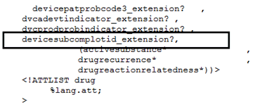

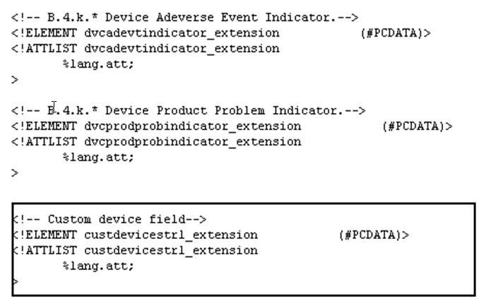

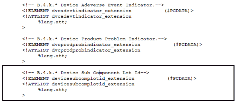

Perform this step if there are custom elements under Argus E2B drug node that is displayed in the Product > Device tab of the Argus Safety Case Form. This is not necessary for other tabs because they are already added to the DTD.
Note: The Argus E2B DTD does not support more than 90 child elements under a parent node. The DTD that is delivered with integration pack has 82 child elements. Therefore, you can add only up to eight custom elements under the drug node. |
For example, if InForm trial is sending a custom field called Cust_Device_Str_1, modify the Argus DTD at <AIA_HOME>/AIAMetaData/AIAComponents/ ApplicationObjectLibrary/ArgusSafety/V1/ schema/ich-icsr-v2.1-FDA-PIP.dtd.
Add a field custdevicestr1_extension to this DTD.
In the custdevicestr1_extension, str and 1 will change depending upon the user-defined field data type and number in Argus.
Add element definition under the drug node as follows:
Add element details as follows:
Save the DTD file.

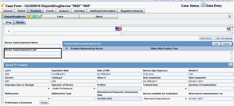

Certain fields in Argus case forms are not imported by the standard integration. If you want to import these fields, additional customization can be done. The following sections will use the example of sending data from InForm form field to Argus Safety Case Form > Product > <Product Name> > Device > Device Subcomponent Lot field.
Custom fields can be added to the InForm logical schema under data set titles Safety_ Case, Subject and Subject_AdverseEvent, MedicalDevice. The alias specified for the custom fields for sending data to non-user-defined fields in Argus Safety must not follow the same naming as the custom fields that are mapped to Argus user-defined fields.
For example, if Study Designer adds a custom field DeviceSubComponentLotID to send to Oracle Argus Safety. Study Designer can define the alias for this fields as custom_subcomp_lotid in the MedicalDevice dataset.

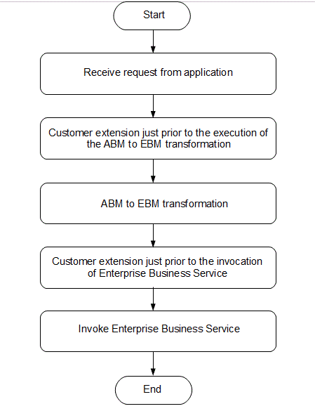

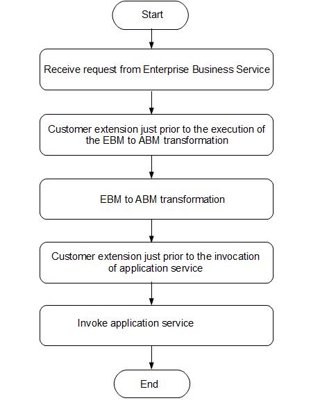

Add custom transformations to custom XSL in ReportDrugSafetyReportInFormRequesterABCS composite.
This scenario assumes that the Oracle JDeveloper is set up with the following configurations:
Resource Palette is configured to browse SOA_MDS database for a given database.
JWS application is configured to which the .jpr files can be added.
Get the ReportDrugSafetyReportInFormReqABCSImpl and ReportDrugSafetyReportArgusProvABCSImpl composites from the application server to the local JDeveloper environment.
This involves copying corresponding composite projects from the application server's folders <AIA_HOME>/services/core/InForm/RequesterABCS and <AIA_HOME>/services/core/ArgusSafety/ProviderABCS to the local JDeveloper environment.

To send non- user-defined Argus Safety fields, perform the following on the Argus Safety Interchange Server:
Create Custom Field in Oracle Argus Safety
Modify the DTD file.
On the Oracle Argus Safety Interchange server, open the <ORACLE_ HOME>/Argus/InterchangeService/DTDFiles/ich-icsr-v2.1-FDA-PIP.DTD.
Add an extension field devicesubcomplot_extension under drug node.
For example, create the following element as shown below in the DTD:
Add element properties to the DTD as shown below:
Figure 3-5 Adding Element Properties to the DTD
Note: The Argus E2B DTD does not support more than 90 child elements under a parent node. The DTD that is delivered with the integration pack has 82 child elements. Therefore, you can add only up to eight custom elements under the drug node. |
Save the DTD file and exit.
Ensure that you always add the extension elements to end of the sequence of child elements. Note that the change in the DTD is equivalent to the change in the ich-icsr-v2.1_integration.xsd as described.

This integration lets you to call external web services from all the ABCS services.
Figure 3-6 shows various invocation points for external web services from a Requester ABCS - ReportDrugSafetyReportInFormReqABCS or ReportDrugSafetyReportResponseArgusReqABCS.
Figure 3-6 Calling Web Services From Requester ABCS
Figure 3-7 shows invocation points for external web services for Provider ABCS - ReportDrugSafetyReportArgusProvABCS or ReportDrugSafetyReportResponseInFormProvABCS.
Figure 3-7 Calling Web Services From Provider ABCS
To invoke an external web service in an ABCS, perform the following:
Open <AIA_HOME>/aia_instances/<instance_name>/AIAMetaData/config/AIAConfigurationProperties.xml.
Locate the ServiceConfiguration section of the ABCS that is being extended.
For example, if you want InForm Requester ABCS to call an external web service, go to Service Configuration with service name as {http://xmlns.oracle.com/ABCSImpl/InForm/Core/ReportDrugSafetyReportInFormReqABCSImpl/V1}ReportDrugSafetyReportInFormReqABCSImpl.
Based on your requirement for control logic, set one of the following extension points to True.
In a requester ABCS, enable one of the following:
PreXformABMtoEBM - Invokes an external web service before ABM to EBM transformation.
PreInvokeEBS - Invokes an external web service before invoking EBS.
In a provider ABCS, enable one of the following:
PreXformEBMtoABM - Invokes an external web service before EBM to ABM transformation.
PreInvokeABS - Invokes an external web service before invoking Application Business Service (ABS).
