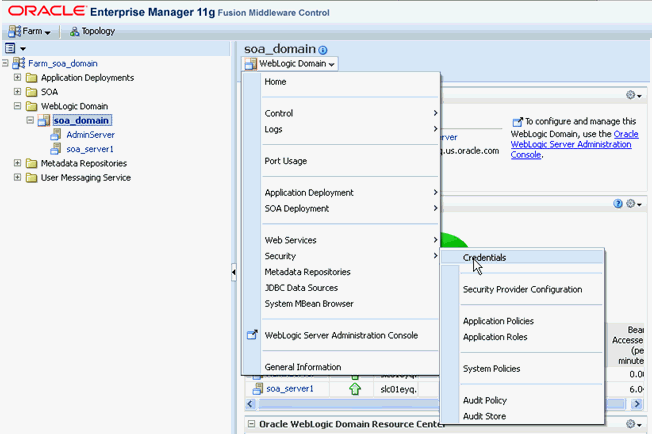

Open Enterprise Manager.
Navigate to Farm_soa_domain > WebLogic Domain > soa_domain.
Click on the WebLogic Domain drop-down box and select Security > Credentials.
In the Credential Store Provider screen, select oracle.wsm.security and expand it.

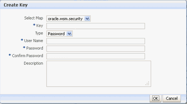

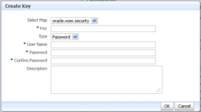

Click Create Key. The Create Key screen is displayed.
In the Key field, enter a value (for example, alltrials.auth.key) and enter the user name and password for InForm Adapter authentication.
Note: Contact the InForm system administrator to obtain these values. |

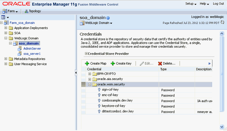

Figure 5-4 Entering a Value in the Key Field
Click OK.
The new key will appear in the list of keys under the oracle.wsm.security group. This key value will be provided either in configuration wizard screens or in HS_TRIAL_SAFETY_CONFIG.dvm.
