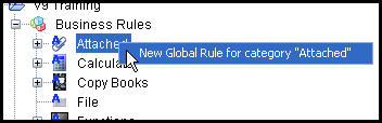

  3. Right-click on a rule category and select New Global Rule for category " ".

The new global rule will appear in the category folder where it was created.
New Global Rule
Attached Rules Right-Click Option

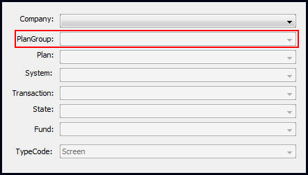

If plan group functionality is enabled, then an additional override level will be available between the Company and Plan fields. Once the company is selected, the Plan Group drop down will list the applicable plan groups for that company. Once the plan group is selected the Plan drop down will list the applicable plans for that plan group.
If Plan Group is disabled (in Properties setting) and there are existing plan groups, then they will appear in the Plan drop down box.
Plan Group Option in Rule Override Wizard
