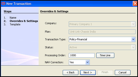

Enter the following items: (Refer to Transaction Type and Processing Order for further information.)
Select the transaction type.
Enter the processing order for the transaction.
Select Yes in the NAV Correction drop down box if the transaction is a financial transaction.
Click Next.

Step 2 of New Transaction Wizard
