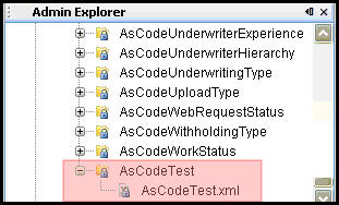

Steps to Add a New Code Name
  1. Open Admin Explorer and expand the Administration folder.
  2. Right-click on the Code Names subfolder.
  3. Select New Code Name.
  4. Enter the new code name, prefixed with AsCode. The system will not save a code without the AsCode prefix in the code name. Once the code is entered correctly, the Finish button becomes enabled.
  5. Click Finish.
New Code Wizard
 New Code Wizard
By default, the new code name will be checked-in. Check it out in order to edit it.
New Code
New Code Displayed Under Code Names Node

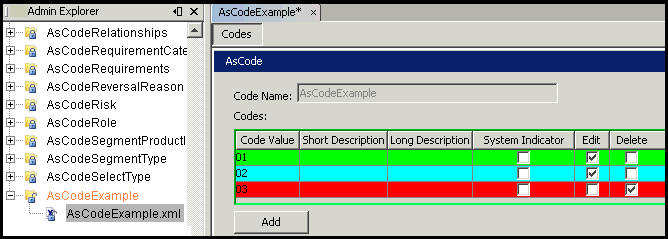

Edit
Selecting this checkbox allows a code to be edited within a particular code name. When a new code is added, the edit checkbox defaults to checked and the code will appear highlighted in blue. If the Edit checkbox is selected on an existing (not new) code, it will become highlighted in green.
Delete
Selecting this checkbox allows a code to be deleted from the particular code name that is checked out. This code will become highlighted in red when the checkbox is selected.
Add
The Add button allows a new code to be added to the particular code name that is checked-out. When a new code is added, a new code line will appear in the codes pane and it will be highlighted in blue with the Edit checkbox defaulting to checked.
Color Coding
The code-editing functionality uses the following color coding (highlighting) to identify the status of a particular code in a code name.
Code
Task
Green
Edit an existing code (not new).
Blue
Add a new code and edit while new.
Red
Delete a code.
New Code Code Color Scheme
Adding, Editing and Deleting Codes in a Code Name
