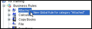

Steps to Create a New Global Rule
  1. Navigate to the Global Rules Explorer.
  2. Open the Business Rules folder.
  3. Right-click on a rule category and select New Global Rule for category " ".
  4. Type the rule name in the first step of the wizard and click Next.
  5. Select the TypeCode from the drop down box.
  6. Click Finish on step three of the wizard. The template information is not required.
  7. Configure the rule.
The new global rule will appear in the category folder where it was created.

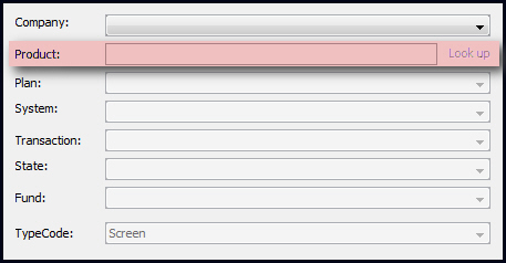

Overrides can be created for the various types of rules and attached to specific plans. From the Global Rules Explorer, new global business rules can be created for each of the rule categories. Right-click on a rule’s folder and select New Override to open a wizard window, which will step through the creation process.
A list of all rules and the override levels that are supported in OIPA for that rule (the rule's context) can be found in the XML Configuration Guide. The Transaction Rules book contains a page called Attached Rule Validation, which lists all rules and their corresponding context.
If Product functionality is enabled, then an additional override level will be available between the Company and Plan fields. Once the company is selected, the Product drop down will list the applicable Products for that company. Once the Product is selected the Plan drop down will list the applicable plans for that Product.
If Product is disabled (in Properties setting) and there are existing Products, then they will appear in the Plan drop down box.

  1. Cick Next on the first screen of the wizard. The name of the business rule cannot be changed.
  2. Select the appropriate override settings for the business rule. The level of override selected will determine what folder the override appears in under the Global Explorer. When looking for the rule, make sure to open the appropriate Override folder.
  3. Click Finish.
  4. Configure the rule.
