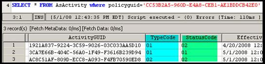

An activity is in pending status when information for an activity is entered but not processed. No calculations or math were run for this activity yet. An activity will be in a pending status because it was manually added or spawned but not processed. Verifying the TypeCode indicates how the activity was processed. Either way the activity record will remain in pending status until it is processed. Once processed, the StatusCode will be updated in the database and the status listed in OIPA will reflect the new status.
Example:
The CoverageCalculation activity was entered manually by selecting it from the activity drop-down box and then selecting the OK button. The activity displays on the Activity screen in a pending status. The activity record in AsActivity table stored the TypeCode 01 because it was manually entered and the StatusCode 02 because it is pending. It is important to note that if the activity was spawned it will have type code 01 as well.
Activity in Database in Pending Status

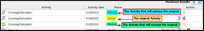

An activity is in shadowed status when it has been recycled or deleted.
Selecting the Recycle button associated with an activity creates two additional activities to be processed. The first is a reversal activity that has green reversal arrows for its Activity Detail icon. The second activity replaces the original activity. The reversal activity must be processed prior to the new activity that will replace the original.
Step 1: Select the recycle button for an activity.
Two pending activities are generated in OIPA for the reversal and new activity.
Two Pending Activities Generated For Recycle

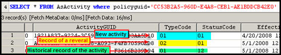

Two additional records are written to the database to track the reversal and new activity.
Reversal Records Written to Database

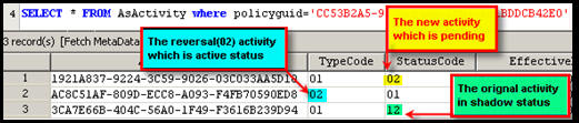

Step 2: Select the Process button for the reversal activity.
The status of the original activity is updated to shadow and the reversal activity status is updated to active.
Active Reversal Activity
The status of the original activity’s record changes from 01(active) to 12(shadowed). The reversal activity changes from 02(pending) to 01(active).
Reversal Activity in the Database

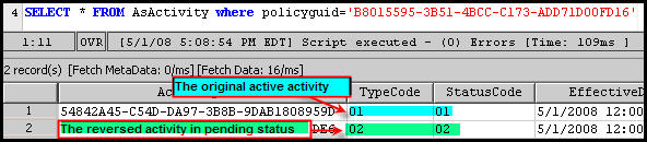

There are now two records, one for the original activity and one for the reversal activity.
Two Reversal Activities in Database
Step 2: Select the Process button associated with the reversal activity. The original activity is then updated to shadowed status and the reversal activity is updated to active status. The database record for the original activity is updated to 12(shadowed) and the reversal activity is updated to 01(active)status.
