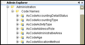

Code Names Folder in Admin Explorer

Open Admin Explorer and expand the Administration folder.
Right-click on the Code Names subfolder.

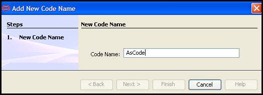

Select New Code Name.
Enter the new code name, prefixed with AsCode. The system will not save a code without the AsCode prefix in the code name. Once the code is entered correctly, the Finish button becomes enabled.
Click Finish.

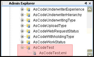

By default, the new code name will be checked-in. Check it out in order to edit it.
New Code Displayed Under Code Names Node

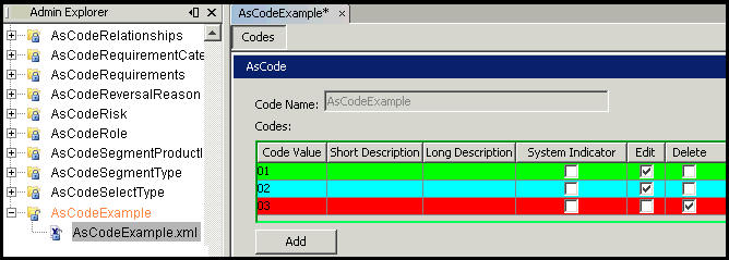

The code-editing functionality uses the following color coding (highlighting) to identify the status of a particular code in a code name.
Code | Task |
Green | Edit an existing code (not new). |
Blue | Add a new code and edit while new. |
Red
| Delete a code. |

Clicking Add on the Codes pane will add a new blank row (code) and the new code appears highlighted in blue.
Double-click in the Code Value, Short Description and Long Description fields for the code in order to add information.
Select the Edit and/or Delete checkboxes for that code as desired. Please see editing codes section above for details.

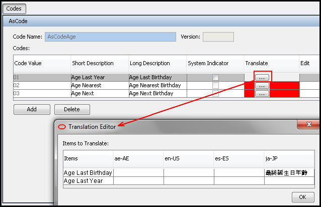

A translation button is available on each row to allow easy access to the Translation editor. Click the node in the row to open the translation values for the Short and Long Descriptions of the code. Make any changes and click OK to close the window and save the changes.
If changes are checked in for a code in AsCode and the translation node is not clicked, then the Rules Palette will open the Translation Editor window so that translation values can be updated if needed. Update any values and click OK to save the changes.
Deleting code values does not remove the translation value.
Translation Button and Translation Editor Window
