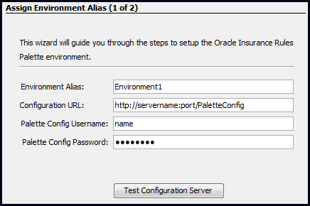

  1. Enter an Environment Alias that distinguishes one environment from another. Only use alphabet characters in the alias. No numbers or other characters are supported at this time.
  2. Enter the Configuration URL provided by the Build Manager.
  3. Enter the Palette Config username provided by the Build Manager.
  4. Enter the Rules Config password provided by the Build Manager.
  5. Click Test Configuration Server to test the connection to the Web Service that will auto-populate the database properties. If the connection is successful, click Next
Step One of Environment Creation Wizard

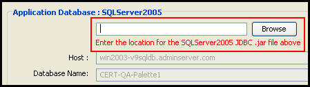

  1. When using SQL Server or DB2 databases, identify the location of the driver files. Browse to the location of the jdbc driver files. (SQL Server uses the jtds.jar and DB2 uses two jar files beginning with db2_***.jar. The file location can be obtained from the Build Manager.) This step is only performed the first time an environment is set-up. If additional environments are created, then this Browse field will not display.
Browse button on step two of creation wizard
Browse Button on Step Two of Environment Creation Wizard
