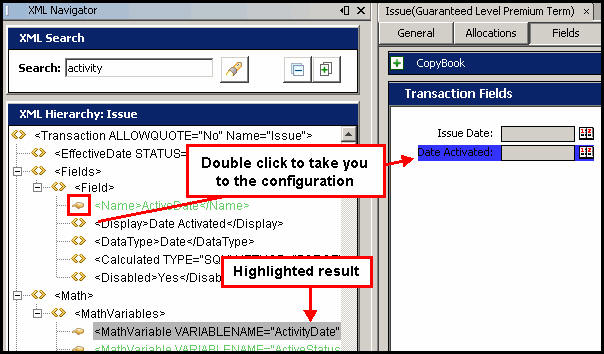

The XML Navigator tab displays the XML configuration for the rule that is open for configuration. The configuration will display in an expandable tree structure. The XML can be expanded expand icon and closed according to element tags. This improves readability. Searches can also be performed from this window. All results are highlighted in the XML Hierarchy box. Any line with an associated Finger icon finger icon can be used to navigate to the point of configuration where it is used.
A transaction, segment or business rule must be open in the Configuration Area in order to use the XML Navigator.
XML Navigator showing search results for activity
XML Search in XML Navigator Tab
