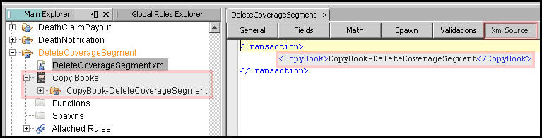

Navigate to the rule where the CopyBook will be called.
Right-click on the XML file.
Check-out the rule.
Open the XML Source Pane.
At the point of configuration the CopyBook should run, type the start and end <CopyBook></CopyBook> tags with the CopyBook-Name as the value.
Save
the rule.
Check-in the rule.
When rule’s CopyBook folder is opened in the Main Explorer tab, the CopyBook being called will be listed.
CopyBook element in Transaction XML

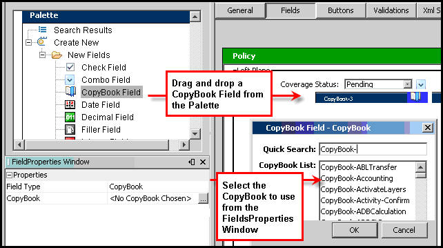

Check-out the rule.
Open the Fields Pane.
Using the Palette, drag and drop a CopyBook field onto the screen.
In the FieldProperties
Window select the
button.
Select the CopyBook from the CopyBook list and select OK.
Save
the rule.
Check-in the rule.
Drag CopyBook from Palette to Fields Pane
