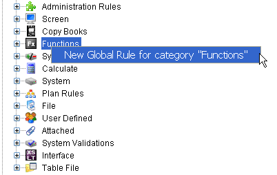

Go to Global Rules Explorer tab.
Right-click on the Functions folder.
Function Right-Click Option
Select New Global Rule for Category Functions.
Enter a name for the function and select Next. Function names should always begin with Function- then the name of the specific function. No spaces are allowed in the function name and the format should be camel case.

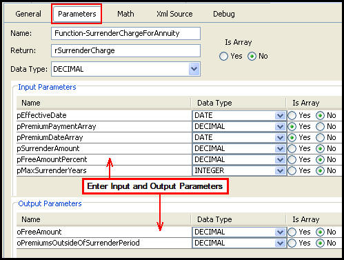

Make sure the Function is open in the Configuration Area. If not, double-click the .xml file to open it.
Click the Parameters tab.
Function Parameters Tab
Enter the name of the function.
Enter the return value. Make sure it starts with the letter r.
Select the Data type.
Click the radio button for Yes or No if function is an array.
Click Add and click in the blank field to enter the input parameters.
input parameter name must begin with the letter p.
select the data type from the drop down box.
specify whether it is an array.
Click Add and click in the blank field to enter the output parameters.
output parameter name must begin with the letter o.
