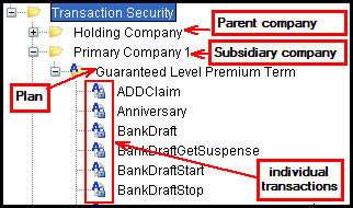

Transaction Security
After Company and Plan security have been defined, the transactions
associated with the company and plans are displayed under the Transaction
Security folder. Plan
folders are listed inside the associated company folder.
Right-Click Options
Security is applied from the top down. Once
Primary Company security is defined in the Company file and the Company pages,
then the Plan Security folder will populate with available plans. Once
Plan security is defined, then the Transaction Security folder will populate
with available transactions.

Transaction Security Folder Structure
