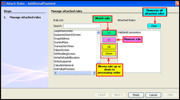

Select the rule to attach from the Rule List.
Use the
button to attach the
rule.
Repeat as necessary.
Select Finish.
Attach Rules Window
Expand
the associated transaction folder in the Main Explorer.
Right-click on the transaction’s XML file.
Select Edit Attached Rules. The rule must be checked-in to see this option.
Select the rule to remove from the Rule List.
Use the
button to remove a rule.
Select Finish. The Attached Rules node may disappear from the navigation tree. If this happens, logout and log back into the Rules Palette to refresh the navigation tree.
