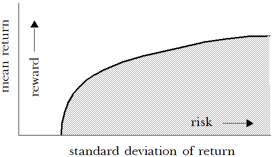

If you were to examine all the possible combinations of investment strategies for the assets described for Portfolio Revisited.xlsx, you would notice that each portfolio had a specific mean return and standard deviation of return associated with it. Plotting the means on one axis and the standard deviations on another axis, you can create a graph like this:
Plotting means on one axis and standard deviations on another axis example.
Points on or under the curve (values lower than the curve) represent possible combinations of investments. Points above the curve (values higher than the curve) are unobtainable combinations given the particular set of assets available. For any given mean return, one portfolio has the smallest standard deviation possible. This portfolio lies on the curve at the point that intersects the mean of return.

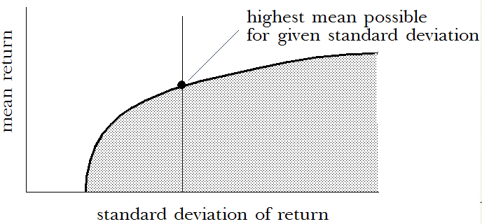

Similarly, for any given standard deviation of return, one portfolio has the highest mean return obtainable. This portfolio lies on the curve at the point that intersects the standard deviation of return.
Highest mean possible for a given standard deviation example.
