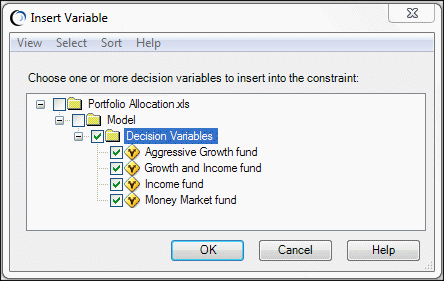

The Insert Variable dialog opens.
Since you want to include all four decision variables in the constraint formula, select each name. To select all four at once, select the box in front of Decision Variables. Then, click OK.
The variables are displayed in the edit box as a sum:
Enter the total investment as $100,000 (without the dollar sign or comma), so that the final constraint looks like:
Money market fund + Income fund + Growth and income fund + Aggressive growth fund = 100000
