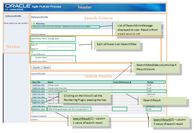

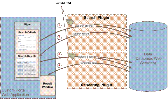

The Custom Portal hosts a View, which is a web page that contains the search criteria and search results. Once a search is performed and search results are displayed, clicking on a result entry will display the final detailed results in the chosen output format.
The following diagram illustrates the processes of a custom portal View:
The numbered steps in the diagram above describe the process as follows:

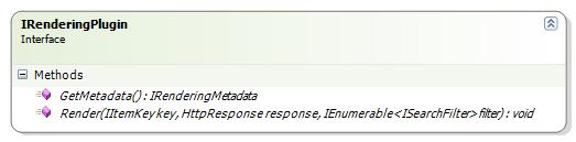

Rendering data involves displaying the desired output results once the search results are displayed and a result item is selected. The Rendering Plugin configured in the Data Admin screen for a View is called to display the result, either in the same window or in a pop-up.
Rendering Plugins can display the data in whichever format is created, such as HTML, PDF, etc. Additionally, the Rendering plugin can also access additional data need for the display of the item selected using the various data access methods specified above.
For instance, if the search results display a list of Ingredient Specifications that contain a specific Nutrient Item, clicking on one of the specifications returned could display more detail about that ingredient spec, such as the category, subcategory, and group, the ingredient statement, and the full list of nutrient items. The Rendering plugin would call specific web services to retrieve this desired data, and then could display it as a PDF document.

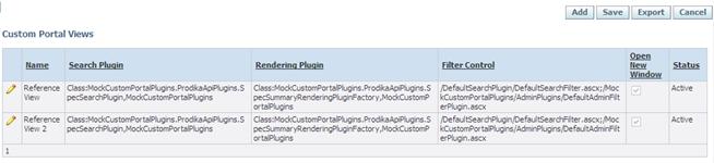

Each View is a separate web page that provides search, filtering, and display capabilities. Users configure a View with a name, status, and whether the individual search results should appear in a new pop-up window or in the same window. Additionally, the search, filtering, and display capabilities of the View are declared in the configuration by specifying custom Plugins and Filter Controls.
Each entry has the following fields:

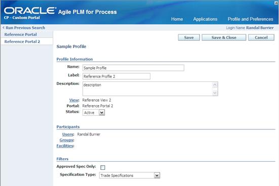

Portal Management screens, accessible in Custom Portal, enable Profiles to be created for each Portal. A Profile is a way to associate a View to various participants (users) and apply filters to the search results that the View provides.
Only users with the role “[CP_ACCESS_ADMIN]” may access the management screens.
Access the portal management screens via http://<servername>/customPortal/Admin/PortalAdmin.aspx and select the Portal to configure profiles for from the left navigation menu.
This will display a Profile search screen to search for Profiles for the selected Portal, or create a new Profile.
Note that to configure a Profile, the relevant View must exist along with the actual Plugins and Filters. In other words, a Profile cannot be configured until the Plugins are set up in Data Admin.

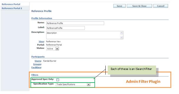

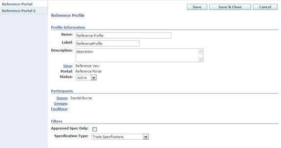

This page allows users to configure a Profile for a View, the display name, the users/participants, and the admin filters.
The Profile Information section contains the following fields:

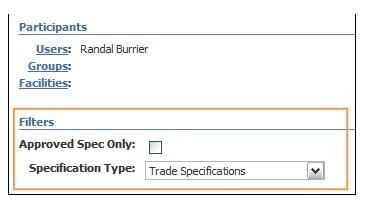

The Participants section is where permissions are set for the Profile. It contains the following fields:
The Filters section will differ by the selected View, as it will load the admin filter control specified in the Data Admin configuration screen for that View. The filters section shown above is based on a reference implementation: it allows the search filter to be restricted to Approved specifications only and to a particular specification type.

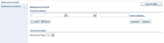

A web control (CustomerPortal.ascx), provided in the Custom Portal web application, must be defined for each Portal that is configured. The control defines the appearance and functionality of the Portal.
Each portal page has four sections:

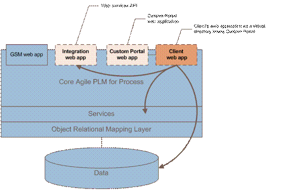

The following diagram presents a simplified model of the architectural components involved in implementing a Custom Portal solution.
The Custom Portal web application hosts the portal pages,
portal management screens, branding, stylesheets, and user authentication.
The Client web application (or assembly), accessible via a
virtual directory in IIS, implements the search, rendering, and filtering
requirements by accessing the Web Services API, the database through direct
queries, and possibly internal PLM4P services and data objects.
The Integration web application is used to host the Agile
PLM for Process Web Services API.
Each of these modules must be installed and configured into an existing Agile PLM for Process environment.

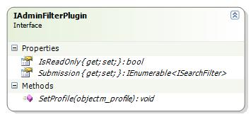

The IAdminFilterPlugin is used in the Profile Management screen to set specific search filters for that profile. This allows multiple profiles to be set with different search filters for the same views.
Admi Filter Pugin
The IAdminFilterPlugin is typically implemented as a user control, using data entry fields to set each ISearchFilter.
The SetProfile method is used to pass in the Custom Portal Profile object, which can then be used to save the Search Filter values to the Profile via the Profiles.SetSearchFilter method. The Search and/or Rendering Plugins can later retrieve these Admin Search filters directly from the Profile.
The IsReadOnly property is used to determine when to make the control editable.
The Submission property is used to get and set the search filters. The profile’s current SearchFilters can be accessed by using the Profiles.GetSearchFilter() method and passing the profile that was passed in via the SetProfile() method.
An example usage could be to set the allowable specification types for the view’s search results. You could create a user control that lets the admin user select from multiple spec types, and create a SpecTypesFilter class that implements ISearchFilter. The Key would simply be some text description to refer to the filter, such as “SPEC_TYPES_FILTER”, and the Operands would be set with the values of the spec type(s) selected. When the Search Plugin later executes the Search, it could evaluate each result to determine if the spec type returned matches the entries in the SpecTypesFilter. (Depending on the search implementation, the search filters might be used as inputs to the search process, or used to evaluate the results and apply the filtering to the results, or both. The usage of the search filter may depend on the filter type itself.)

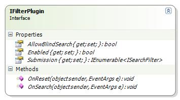

Filter Plugins function much like Admin Filter Plugins. Filter Plugins are used in the Search criteria section, and contain a list of SearchFilters that allow the user to enter values for the search process.
The IFilterPlugin is typically implemented as a user control, using data entry fields to set each ISearchFilter. The Search Filters entered are passed in as parameters (along with the AdminSearchFilters) to the SearchPlugin’s Search() method.
The Submission property is used to get and set the search filters. The search filters are retrieved from the form’s data entry fields, and are then passed into the Search Plugin.
The Enabled property is used to determine when to make the control editable. Because the Filter Plugins are used in the search process, this is usually set to true.
The AllowBlindSearch can be used to indicate if the search should be allowed without any search criteria.
The OnReset and OnSearch methods are present to perform any needed event handling, such as clearing the search filters.

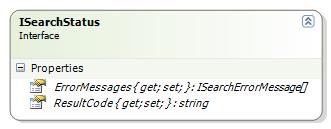

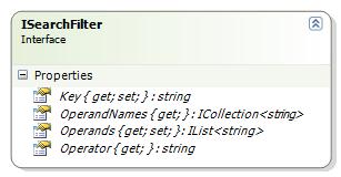

Search filters are passed to the Search operation of the Search Plugin. Each search filter contains a Key, which identifies the type of search criteria, and a list of Operands, which are the values to search by.
A simple example of using a SearchFilter would be to filter the results based on specification type. Setting the Key=”SPECTYPE” and the Operands to a list of desired spec types (ex: ingredient, trade). The SearchPlugin would then use the filters and filter out specs that were not of the correct type.
Note that the OperandNames and Operator properties are currently unused.

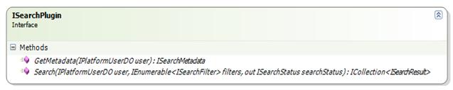

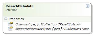

Portal pages display views using Search Plugins. Each View has an ISearchPlugin that specifies what search criteria to display, performs a search, and returns the result data.
Criteria and result column metadata is returned by the GetMetadata() method. The Search() method handles the actual data.
Portal pages query Search Plugins for the information to display. They need to know what type of search Result to offer the user. The pages also need to know what columns to add to the result grid.
The GetMetadata() method takes the current user as an input parameter and returns criteria and result column metadata as an ISearchMetaData.
The Search() method takes the current user as an input parameter, a list of ISearchFilter objects to filter the results, and passes an ISearchStatus object which will be populated with overall result of the operation and a list of error/warning messages. The result of the Search call is a collection of ISearchResult objects.
The ISearchMetaData interface provides access to the search result columns and the supported item key types.
The Columns property lists the result columns returned by the search as an IResultColumn.
Each column (IResultColumn) has a display label for the column header, and a MaxCharCount property that sets the max column width.
A SearchStatus object is passed to the SearchPlugin’s Search method, and is populated with an overall result of the search, and a list of error messages. The result can be evaluated to determine how to handle the error messages. The error messages can be as display information to the user.
The Web Services API operations all return a result code and error messages indicating any issues encountered when calling the web services. For instance, if the input passed in to the web service is in an invalid format, an error message will be returned. This can be used in the UI to inform the user about of the error.
The error messages are returned as an array of ISearchErrorMessage objects.
Each ISearchErrorMessage object contains a description and a message code.
The Search Plugin returns a collection of ISearchResult objects. The SearchResult contains a Key property, which is passed to the Rendering Plugin. This can represent a Spec Number, cross reference, etc, which the Rendering Plugin will then use to retrieve additional information for display purposes.
The indexer returns the value of the column to display, where the index represents the column index.
The IItemKey interface is a flag interface, with no implementation requirements.
For instance, the RenderingPlugin could receive a specification number, call one or more web services to retrieve certain specification information, such as the list of Allergens, create an XML version of the data, and send it to Oracle BI Publisher for PDF rendering and printing. Alternatively, the renderer could use the data from the web services to create an HTML representation of the data.

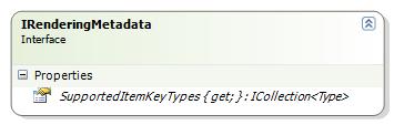

The IRenderingPlugin interface contains a Render method, which is responsible for display the final result item, and a GetMetadata() method which returns the support items for that rendered.
The Render() method takes the key passed in from the Search Results selection, the Http Response, and the Search filters. It is responsible for rendering the final output of the View to a stream. The HttpResponse object must have the ContentType property set to the desired MIME Type, and the file extension for the format it is rendering.
Detailed examples of using the various interfaces described above will be demonstrated in the Reference Implementation section below.
The CustomPortal.ascx class (user control) is the controller for the entire search process. It delegates to the Header, Navbar, Search Panel, and Results Panel controls to render the page. It reads Portal configuration details from the database for the named Portal, loads the Filter Plugin control and the Search and Rendering Plugins.
Any ASPX file may serve as a portal page by including a CustomerPortal control, and passing it the portal name, as such:

Implementing the Search, Filtering, and Rendering capabilities will require a way to access the Agile PLM4P data. This may be achieved use existing web services, direct database queries, using PLM4P internal data objects and services, or some combination of all three. Please review the Accessing Data section above for an overview of these approaches.
In this section, we will discuss these approaches in more technical detail.
The Agile PLM for Process Web Services API provides over 40 web services that can be used for various data access needs. Incorporating web service calls into the search and rendering process is fairly simple, but requires some analysis of how to orchestrate the various web service calls.
The web service calls may be used in multiple steps of the search process, namely as part of the search, and then once a result item is selected, other web services may be called as part of the rendering process.
Visual Studio .NET version 8 provides simple ways to create web service references. Using the Add Service Reference feature will create the service reference, and also configure the service endpoint information in the web.config or app.config of the project.
The results of many of the existing web service calls can (in part) be used as inputs to other web service calls. Chaining the web service calls in this manner allows for the easy retrieval of various data sets to compose a desired output.
For example, using the GetSpecForCriteria web service (to search for Approved Ingredient Specs that have been modified in the last month, for instance) will return a list of specification numbers (and a list of cross references). The spec numbers can then be used as input parameters when calling the GetSpecSummary web service to retrieve the spec names for those specifications.
Note that in Visual Studio .NET, creating a web service client for each service contract will set up a unique namespace for each service. The common data contracts in these services therefore are not equivalent objects. To better enable cross client coding, one could modify the classes by adding a shared interface and program for that interface.
For instance, the tMessage class is returned in a list as part of every web service call. It contains an error message code and description for any warnings/errors that occurred in the web service calls. Updating each tMessage class to add the ISearchErrorMessage interface will allow the use and display of these errors in the Search UI.
Many of the web service calls that retrieve specification data use input criteria that impact which specifications are returned. For instance, the AllowApprovedSpecOnly flag, passed into many calls that retrieve specs, dictates whether the specification(s) returned must be in an Approved workflow status or not. If this behavior should be user selected during the search process, then this flag could be a Search Filter that users can select, and its value would then be passed into the web service call.
The data returned from each web service call may depend on the calling user’s security privileges: Specifications that the user does not have Read permission, or Business Unit visibility to, will not be returned; Object Level Security rules are enforced for the calling user for Custom Sections and Extended Attributes; etc.
There are two ways that the PLM4P Web Services authenticate users for web service calls:
1. Using one declared user for all the web service calls. This requires the username be entered in the environmentvariables.config when setting up the Web Services. The web service client will therefore not pass in any user information.
2. Passing in the username and password for each and every web service call. This requires the web service client to create and pass in a UsernameToken.
Details of the configuration of the Web Service API can be found in the Agile Product Lifecycle for Management for Process Web Services Guide.
The approach used by the web service clients must adhere to the way authentication is configured for the Web Services API.
Required data that is not available via the current Web Services may be retrieved using custom database queries. Read access to the database and knowledge of the database structure will be required. The Database Schema documentation available in the Extensibility Pack provides a thorough view of the many database tables and their relationships to other tables. It also provides example SQL code to assist query development.

To set up the MockCustomPortalPlugins reference implementation, you must do the following:
The reference implementation code will also need to be installed as follows:
You must set up the following configuration in the Data Admin screens:
§ Name=”Reference Portal 2”
§ Cache Timeout =any value, ex: 30 (minutes).
§ Status=Active
Save your changes.
§ Name=”Reference View 2”
§ Search Plugin = ”Class:MockCustomPortalPlugins.ProdikaApiPlugins.SpecSearchPlugin,MockCustomPortalPlugins”
§ Rendering Plugin = “Class:MockCustomPortalPlugins.ProdikaApiPlugins.SpecSummaryRenderingPluginFactory,MockCustomPortalPlugins”
Filter Controls = “/MockCustomPortalPlugins/FilterPlugins/SpecSearchFilterControl.ascx;/MockCustomPortalPlugins/AdminPlugins/DefaultAdminFilterPlugin.ascx”
Note that the filter controls value includes two (2) Filter controls separated
by a semicolon. The first value is the filter control used during the search,
and the second value is the AdminFilter control used in the Profile Management
screen.
§ Open New Window = checked
§ Status=Active
Save your changes
You will need to set up a Portal Profile for your new Portal View

The code-behind uses the name of the input fields as the key of the ISearchFilter classes, and the value(s) of the inputs as the Operand(s). For example, for the Spec#-Issue# search, the spec# value is the ISearchFilter’s Operand[0] and the issue# value is the Operand[1].
SpecSearchFilterControl.ascx.cs:
public partial class SpecSearchFilterControl : System.Web.UI.UserControl, IFilterPlugin
//… code removed for brevity
public IEnumerable<ISearchFilter> Submission
get { return GetSubmittedCriteria(); }
set { }
private IEnumerable<ISearchFilter> GetSubmittedCriteria()
List<ISearchFilter> filters = new List<ISearchFilter>();
ISearchFilter nameFilter = GetSpecRelatedfilter(lblSpecName.Text, txtSpecName.Text, null);
if (nameFilter != null)
filters.Add(nameFilter);
ISearchFilter specNumFilter = GetSpecRelatedfilter(lblSpecNumber.Text, txtSpecNumber.Text, txtSpecIssueNumber.Text);
if (specNumFilter != null)
filters.Add(specNumFilter);
ISearchFilter crossRefFilter = GetSpecRelatedfilter(lblCrossReference.Text, txtSystemID.Text, txtEquivalentValue.Text);
if (crossRefFilter != null)
filters.Add(crossRefFilter);
if (filters.Count > 1)
throw new ArgumentException("Only one of the three criteria (Spec Name, Spec #, or Cross Reference) allowed to be submitted.");
foreach (ISearchFilter filter in filters)
yield return filter;

To allow the admin search filtering in the Business Requirement’s requirement 2 above, we will create an AdminFilterPlugin that contains two search filters – one that sets the Spec Type and the second that sets the Approved Only flag. [Note: we are making the spec type search filter editable even though our Business Requirement restricts the type to Trade Specs, so that we could reuse this Plugin for some other View.]
These search filters (combined with the Filter Plugin’s user entered search filters) will be used as input criteria to two web services that will be used for the search:
The AdminFilterPlugin will also be a user control that will allow admin users to select from a list of spec types and a checkbox for the approved only value. It is accessible from the Profile management screen.
DefaultAdminFilterPlugin.ascx:
<%@ Control Language="C#" AutoEventWireup="true"
CodeBehind="DefaultAdminFilterPlugin.ascx.cs"
Inherits="MockCustomPortalPlugins.AdminPlugins.DefaultAdminFilterPlugin" %>
<%@ Register TagPrefix="xwc" Namespace="Xeno.Web.UI.Controls" Assembly="XenoWebControls" %>
<table class="cssxBaseList">
<tr>
<th><%= Translations["lblApprovedSepc"]%>:</th>
<td>
<xwc:BoundCheckBox id="chkApprovedSpec"
BoundProperty="AllowOnlyApprovedSpec"
runat="server"
checkedImageURL="../images/checked.gif"
uncheckedImageURL="../images/unchecked.gif"
IsReadOnly='<%# IsReadOnly %>' />
</td>
<tr>
<th><%= Translations["lblSpecType"]%>:</th>
<td>
<xwc:BoundDropDownList
ID="ddSpecTypes"
BoundProperty="SpecType"
BoundItemsProperty="SpecTypes"
BoundItemsValueProperty="Key"
BoundItemsTextProperty="Value"
DefaultValue=""
RunAt="server" />
</td>
</tr>
</table>
The code-behind retrieves any saved values for the filters from the current Profile, and must save any changes back to the profile.
The SpecType SearchFilter uses the SearchStrategyFactory.SPEC_TYPE value for the Key and the 4-digit object type (the key of the specTypes drop down) as the Operand[0] value.
The AllowApprovedSpecOnly SearchFilter uses the SearchStrategyFactory.APPROVED_SPEC_ONLY value for the Key and the checked status of the checkbox for the Operand[0] value.

set
if (AllowApprovedSpecOnlyFilter != null)
AllowApprovedSpecOnlyFilter.Operands = GetOperands(value.ToString());
else
AllowApprovedSpecOnlyFilter = new SearchFilter();
AllowApprovedSpecOnlyFilter.Key = SearchStrategyFactory.APPROVED_SPEC_ONLY;
PushData();
public void SetProfile(object profile)
m_profile = (ICPProfile) profile;
The SetProfile method is called by the framework when loading the Profile Management screen. It is used to pass the profile to the admin filter control, so that the search filters can be retrieved and saved.
The Submission property’s get accessor retrieves the search filters from the profile.

The SpecSearchPlugin delegates the Search process to a Search Strategy class, which uses the SearchStrategyFactory to create a Search Strategy based on the ISearchFilter list being passed in. For example, if the search filter used is the spec number, it will create a GeneralSpecSearchStrategy, while if the search filter is the spec name, it will create a SpecTypeSearchStrategy.
The GeneralSpecSearchStrategy’s search process uses the web service transfer objects for the input, and converts the results into individual SpecSummaryResult objects used for display.

The web service’s tResponseHeader contains the overall result of the operation and a list of messages. The DataTools.GetSearchStatus() method maps this response to the ISearchStatus output parameter searchResult. Note that this method will only work if you have modified the web service client’s tResponseHeader to implement the IResponseHeader interface and the tMessage to implement the ISearchErrorMessage interface.
The return code converts the tSpecificationSummaryWrapper array to a SpecSummaryResult array by passing in a delegate method to the Array.ConvertAll() method.
Calls to the SpecTypeSearchStrategy class perform a spec search using the spec name. This class extends the GeneralSearchStrategy class, uses the GetSpecNumbersForCriteria, then passes the result to the GeneralSearchStrategy.
Our SearchPlugin defines the columns that will be used in the results through the GetMetadata method.
public sealed class SpecSearchPlugin : IFactory<ISearchPlugin>, ISearchPlugin
/// ... code removed for brevity ...
public ISearchMetadata GetMetadata(IPlatformUserDO user)
return new MyMetadata();
/// <summary>
/// SearchResult's Meta data: column and key type
/// </summary>
private sealed class MyMetadata : ISearchMetadata
public ICollection<IResultColumn> Columns
get { return SpecSummaryResult.GetColumns(); }
public ICollection<Type> SupportedItemKeyTypes
get { return new Type[] { typeof( SpecSummaryResult ) }; }
The SpecSummaryResult class will provide access to the result columns and the values for each row. It implements the ISearchResult interface, which provides a Key property (which will pass the ItemKey to the RenderingPlugin) and an indexer (which provides access to the column values).
The SummaryWrapper property contains the actual results of the GetSpecSummary web service call. Passing the SpecSummaryResult object (as the IItemKey) to the RenderingPlugin allows the RenderingPlugin to access that data directly for rendering or for use in other web service calls.
SpecSummaryResult also contains internal classes for each column: each implements the IResultColumn interface, providing the Label property for the column name, and the MaxCharCount for the length. Additionally, each internal ResultColumn class implements a GetValue() method from a new interface called IValueExtractor that provides the value to display for each result.
Rendering the final output data indicated in the Business Requirement’s requirement 4 involves several steps. To retrieve the data required, we will be calling a combination of web services and direct database queries.
The SpecSummaryRenderingPluginFactory class is used to render the required data to XSL-FO and then renders the FO into PDF.
The Render method takes an IItemKey as the object key, which is passed in as a SpecSummaryResult from the search results as discussed above. The Render also takes the HttpResponse and the list of search filters, which can then be used to filter out any other data retrieved.
public class SpecSummaryRenderingPluginFactory : IFactory<IRenderingPlugin>, IRenderingPlugin, IRenderingMetadata
///...code removed for brevity...
public void Render(IItemKey key, HttpResponse response, IEnumerable<ISearchFilter> filters)
SpecSummaryResult summary = (SpecSummaryResult) key;
MemoryStream foBuffer = new MemoryStream( );
RenderFO( foBuffer, summary.SummaryWrapper.SpecSummary, filters );
ConvertFoToPdf( foBuffer, response.OutputStream );
response.ContentType = MimeType;
get { return new Type[] { typeof(SpecSummaryResult) }; }
