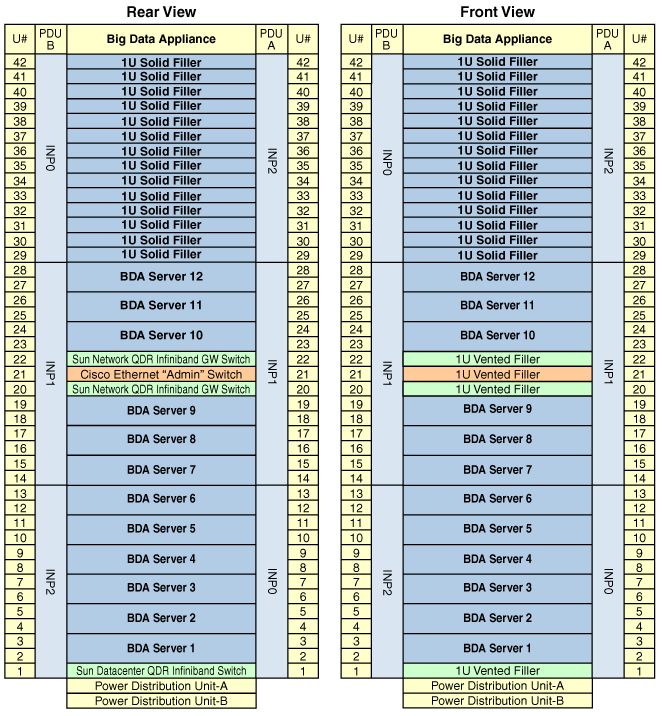

The following figures show the front and rear layouts for three configurations of Oracle Big Data Appliance X4-2 and X3-2: full rack, starter rack, and starter rack with one in-rack expansion kit.
Figure C-1 shows the layout of a full rack for Oracle Big Data Appliance X4-2 or Oracle Big Data Appliance X3-2.
Figure C-1 Oracle Big Data Appliance X4-2 Full Rack Layout

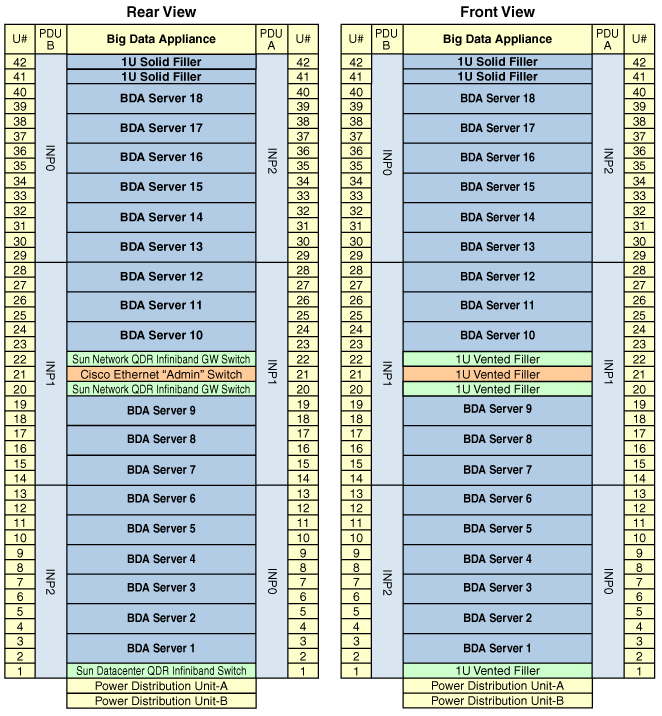

Figure C-2 shows the layout of a starter rack for Oracle Big Data Appliance X4-2 or Oracle Big Data Appliance X3-2.
Figure C-2 Oracle Big Data Appliance X4-2 Starter Rack Layout

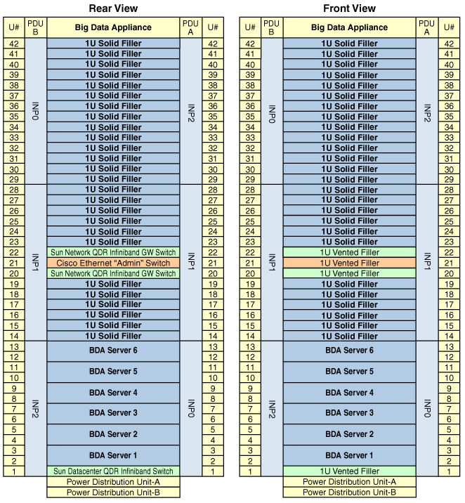

Figure C-3 shows the layout of an Oracle Big Data Appliance X4-2 or Oracle Big Data Appliance X3-2 starter rack with one in-rack expansion kit.
Figure C-3 Oracle Big Data Appliance X4-2 Starter Rack With In-Rack Expansion
