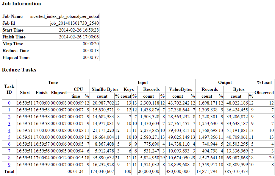

Figure 4-1 shows the beginning of the analyzer report for the inverted index (invindx
) example. It displays the key load coefficient recommendations, because this job ran with the appropriate configuration settings. See "Collecting Additional Metrics."
The task IDs are links to tables that show the analysis of specific tasks, enabling you to drill down for more details from the first, summary table.
This example uses an extremely small data set, but notice the differences between tasks 7 and 8: The input records range from 3% to 18%, and their corresponding elapsed times range from 6 to 20 seconds. This variation indicates skew.
Figure 4-1 Job Analyzer Report for Unbalanced Inverted Index Job

The reports are stored by default in the job output directory (${mapred.output.dir}
). Following is the structure of that directory:
job_output_directory
/_SUCCESS
/_balancer
ReduceKeyMetricList-attempt_201305031125_0016_r_000000_0.xml
ReduceKeyMetricList-attempt_201305031125_0016_r_000001_0.xml
jobanalyzer-report.html
jobanalyzer-report.xml
orabalancer_report.xml
/_logs
/history
job_201305031125_0016_1372277234720_jdoe_invindx_nobal
localhost.localdomain_1367594758596_job_201305031125_0016_conf.xml
/part-r-00000
/part-r-00001
